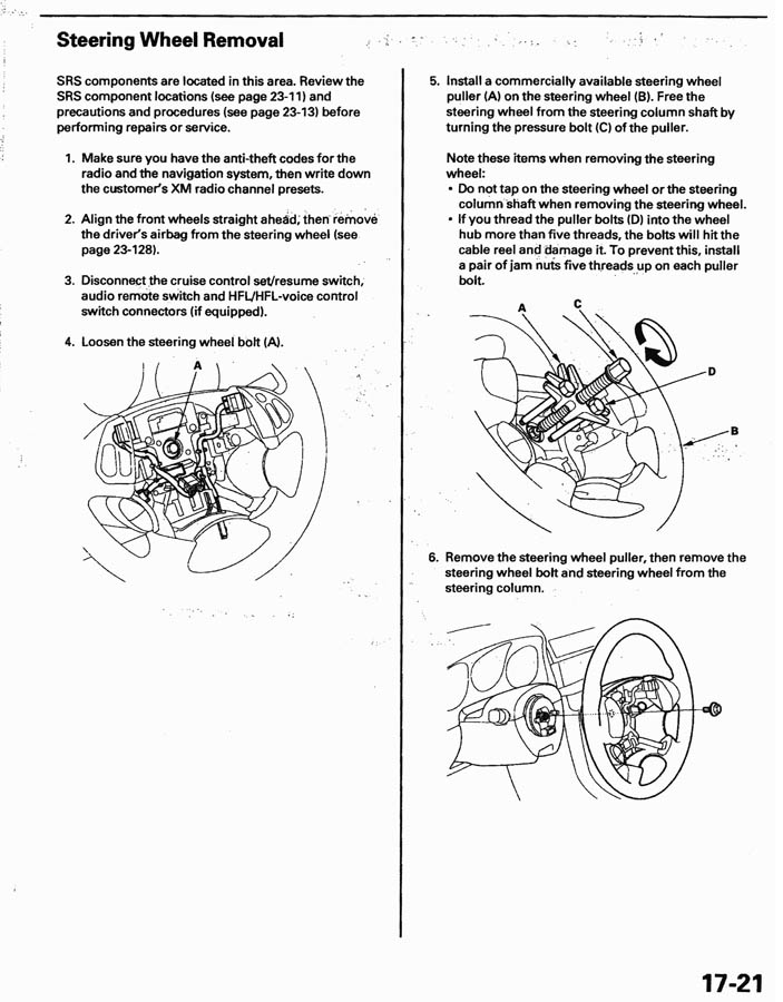

i purchased the steering wheel option from the dealer and im going to attempt installing it myself. im familiar with using the steering wheel puller tool but i dont know what the torque spec is for the bolt that holds the steering wheel in place. can someone with a Helms service manual please look it up for me? thanks in advance for your help.....

29 lb/ft

Like he said 29 lb/ft
