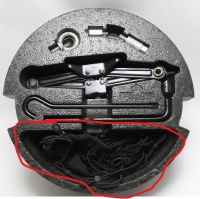

What is that mesh at the bottom of that thing for? To divide trunk?

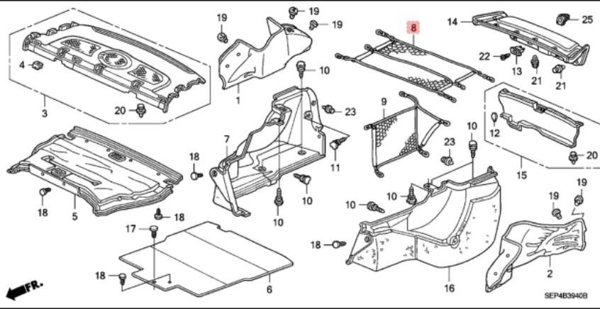

#8 below. 84603-SEP-A00; Net, Trunk ; Cargo Net

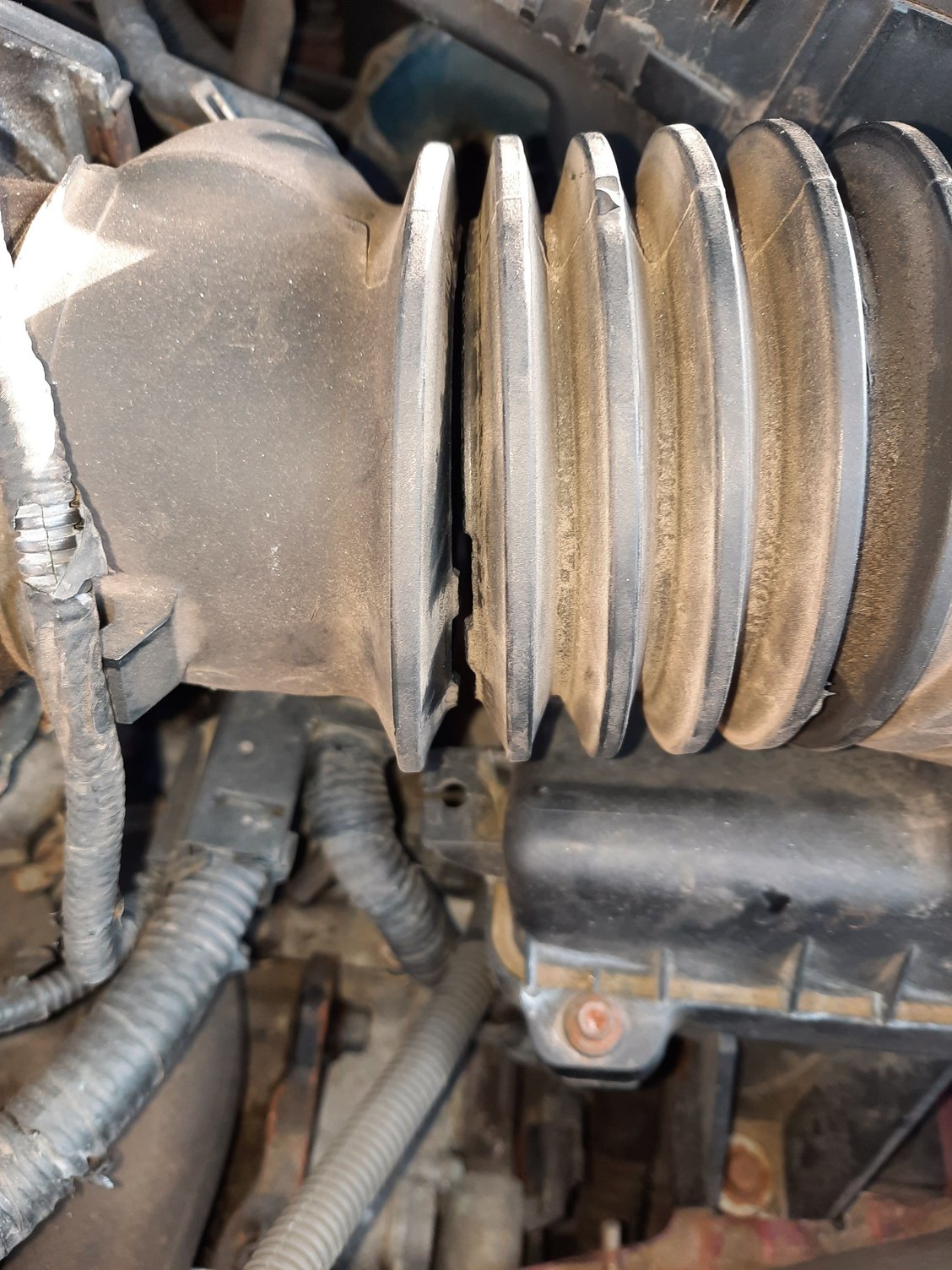

Just order a new intake pipe from rock auto. They're like $20
Old Mar 2, 2023 | 03:52 PM
GhostTL09's Avatar
Joined: Mar 2014
Posts: 2,172
Likes: 863
From: Georgia
OP read your manual, then google your questions, then google answers on Azine and you will be golden. That is most likely the original throttle hose which I guess is as hard as a rock. Please just replace it and clean the throttle while you're at it. If the jesus clamp is rusted, replace that also.
