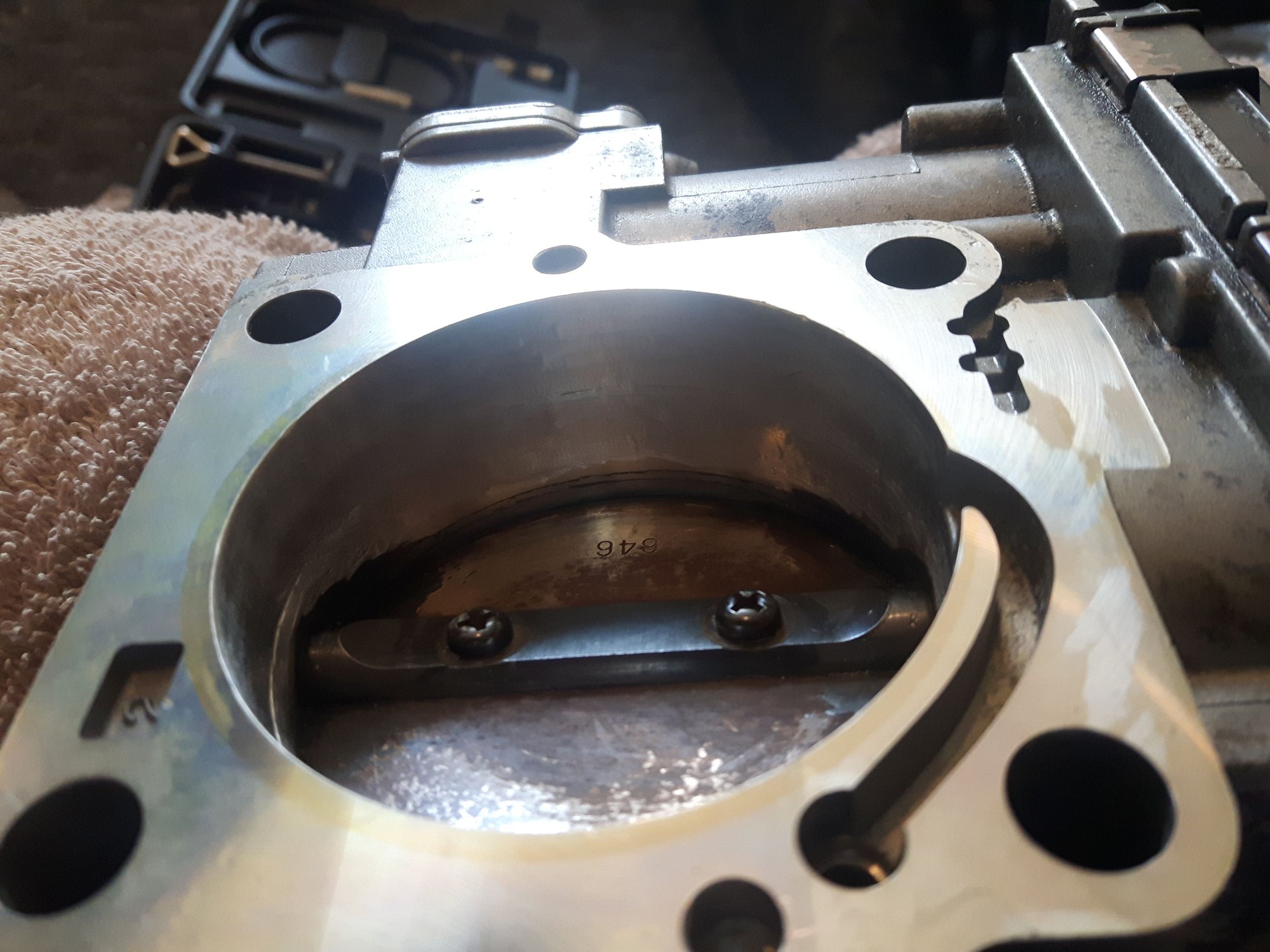

Thanks for the warning I do want to have the complete aspec lip but I've got a bunch of other stuff to do first. Got the day off work so I'm gonna clean the EGR, port and polish throttle body and install an aFe silver bullet and HPS Sri. Pics to follow once I get in there

Just finished a full and hot (+30c) day in the garage I'm filthy and I stink so obviously it was a good time. I had an aFe silver bullet tbs and HPS Sri to install and I figured hey if I'm taking things apart I may as well clean the EGR port and clean up the inside of the throttle body. The tb was covered in carbon and there was a pretty big lip that i smoothed out so it was definitely worthwhile and it made installing the tbs and sri a relative breeze having the plenum out of the car.
