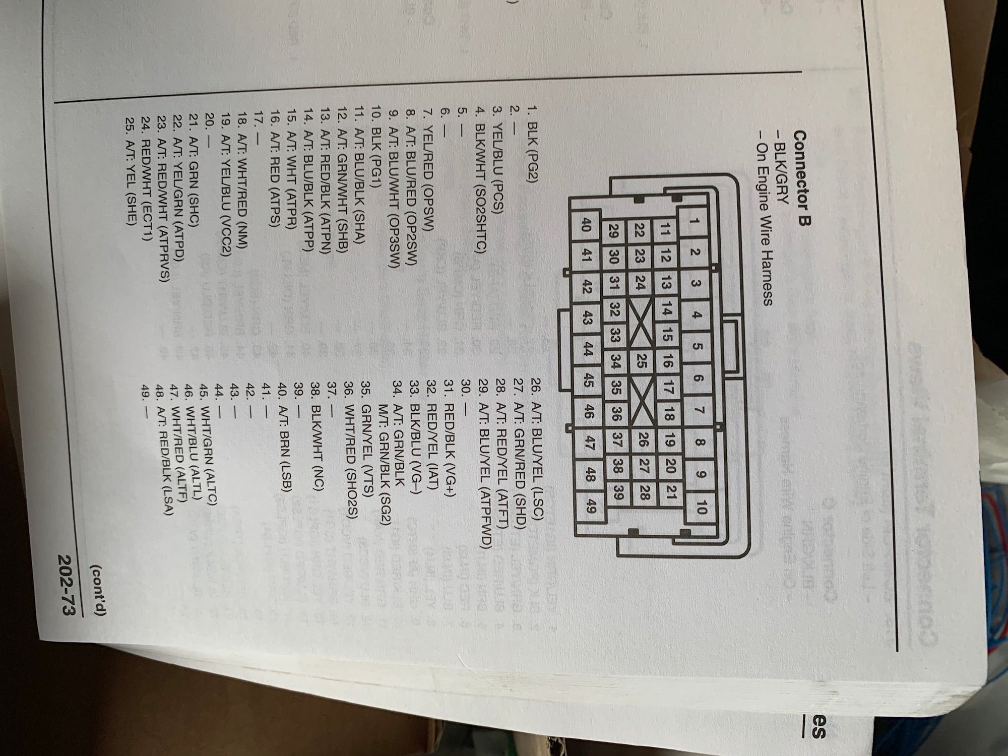

Does anybody have or have access to an ecu pinout for the j35 engines? I am installing one in a jet boat with an aftermarket ecu in New Zealand, and want to use the standard engine loom rather than build a new one.
Just a diagram of the plugs and wire colours etc would be great.
Cheers

hat‘s what i have
