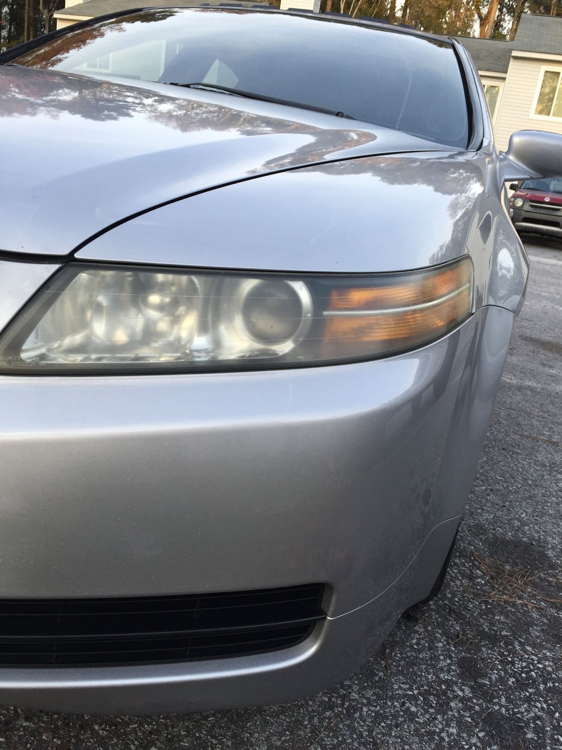

So I'm about to pickup the 3M kit to finally restore my headlights since I got the car 1 year ago (looks all nasty hazed/yellowed).
So now I'm trying to decide between different options for protecting the headlight from further damage (since otherwise I read ppl saying the haze/yellowing may come back within 1 yr)
Liquid/pour-on types: Meguiar's, Opti lens, and various other branded "headlight protectant/sealant"
Film-types: Lamin-X (has read some good things about this here), local window tint shop per poster here.
Lamin-X has a 7 year warranty so that seems quite reassuring and they do sell precuts for the 3G TLs......
Is there a definitive solution to what is best way to protect the headlight after restoration?
