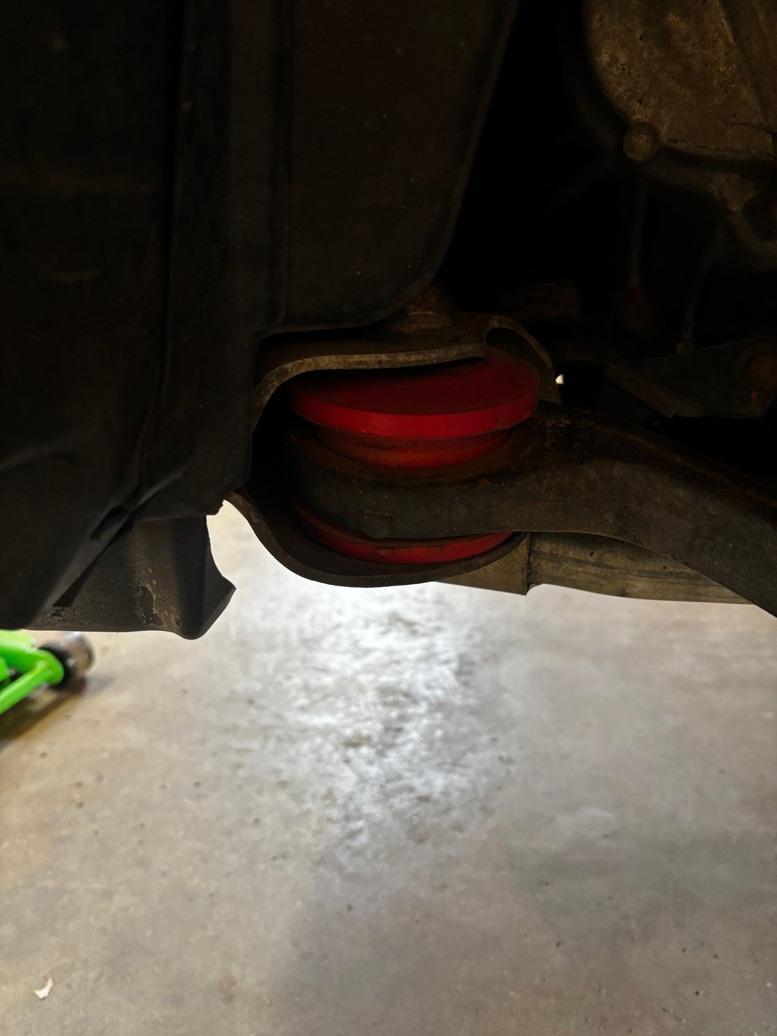

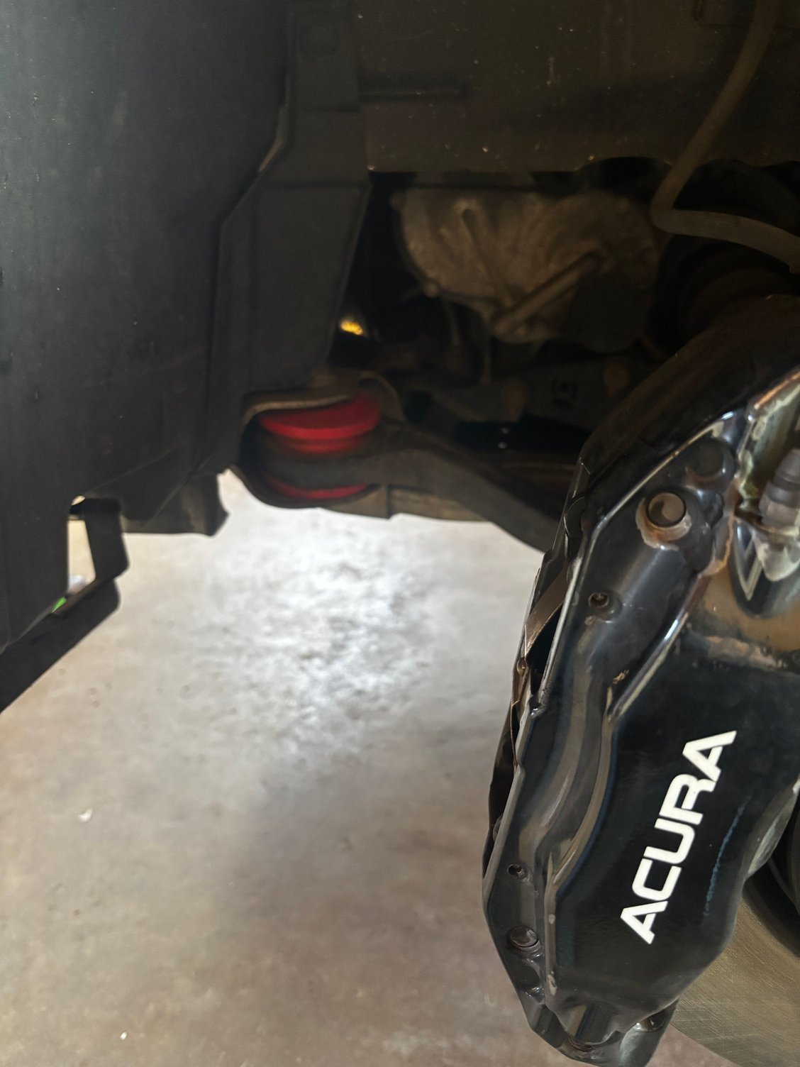

Posting this because I didn’t see anything on the Suspension Bros set when I was looking.
Ditching the Suspension Bros LCAs and going with SuperPros. The Suspension Bros were not good. As you can see the arm moves around the bushing. ALL the movement should be constrained to the bushing. I would hear them moving on the bushing, coming up to stop signs, when it was dry out. I’m hoping this helps with all the wheel hop as well. Let’s hope the SuperPros are better. My advice would be to buy stock LCAs before going with Suspension Bros.
Im glad that suspension bros were trying for our cars but its too bad that the bushings were not designed properly.
You can see the arm moving around the bushing

That first bushing looks like it’s half way installed in the control arm.
Old Apr 28, 2026 | 09:53 PM
TypeS-Optimus's Avatar
Joined: Apr 2026
yeah the inner race just fell out of them after I tossed them in the scrap pile. I would venture to guess it’s just a really bad urethane.
