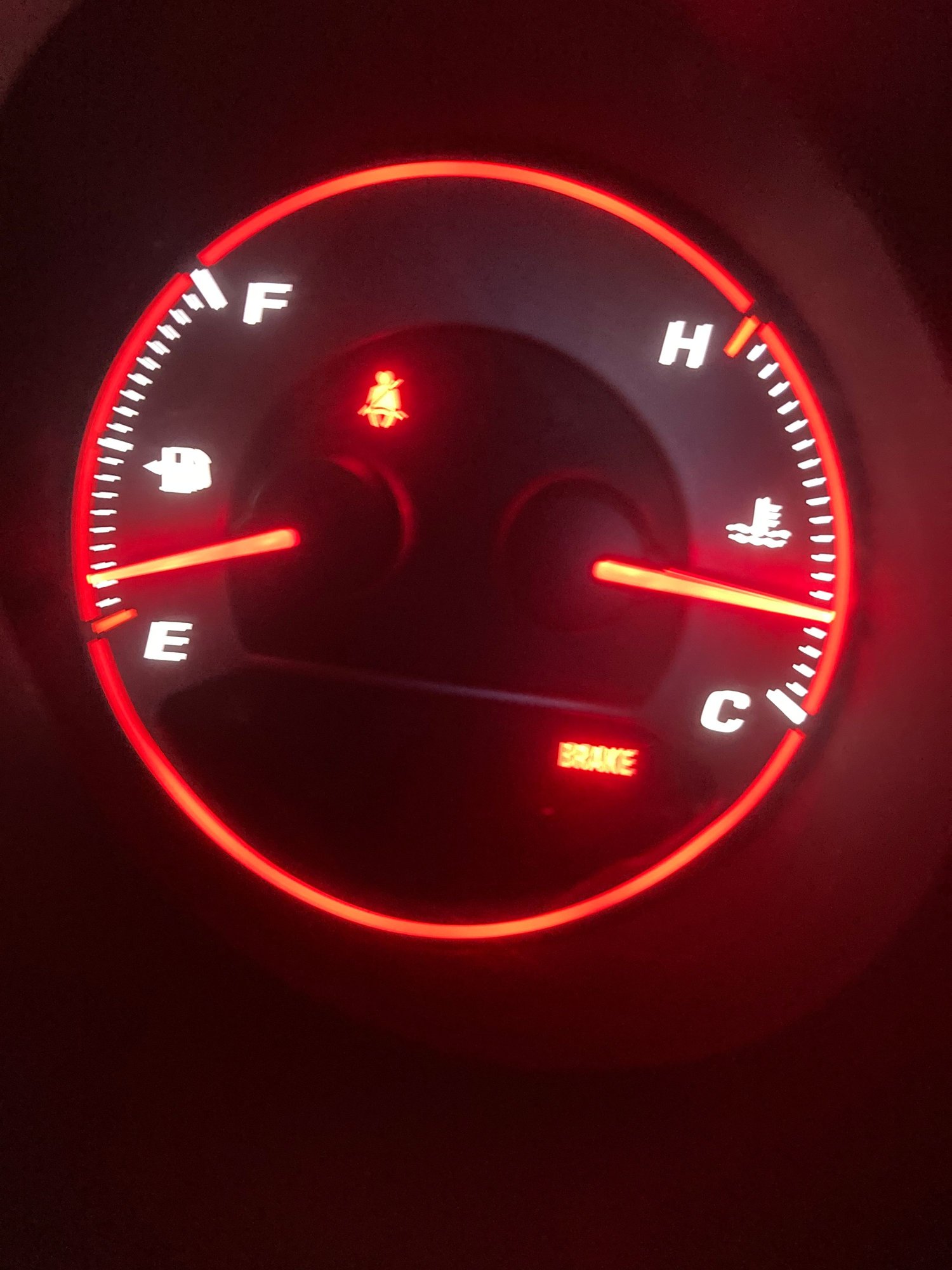

Here's basically what I was talking about. Top picture the 07 Type S auto after a 20 mile commute to work...
Bottom picture the 08 Type S 6MT after the same 20 mile commute work...yea I need gas lol.
It doesn't seem anything to worry about, the 07's gauge never goes any higher then that...Maybe as mentioned before a replaced thermostat, I mean it does have 176,000 miles to the 08's 119,300.

the 07 auto looks to be in-line with mine. my thermostat was replaced a couple years back, so its most likely functioning as it should be.

@jeffstlnote, if anything, I'd say the 6MT is running too cool.

You guys know that this gauge might not be really calibrated? It doesn't matter much and doesn't even say what position corresponds to what temperature. It's just "this much" hot.
In mine 08 base AT it will stay around 1/3 of the way and engine temp is just fine. If you really want to know, use scan tool and view live data. If you don't trust car's sensor (which might go bad) use IR thermometer and point at upper rad hose. At operating temp is should be relatively close to what car is seeing.

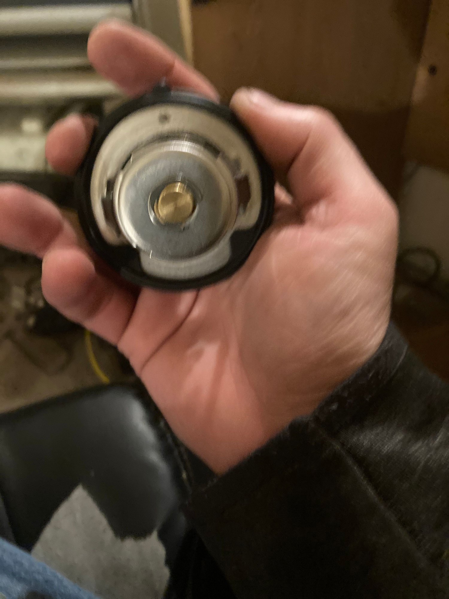

Originally Posted by peter6
Just connect the scanner, read the temp, and get it over with. Computer would most likely notice the stuck thermostat and set a code, especially in colder weather, so you would have a check engine and no heat. Easy to notice, unless you have >70F all the time where you live.
Yup it indeed threw up the check engine light on the dash this afternoon, heats warm but in comparison to the 07, not as much. Going to have my mechanic run the codes and see...but as usual ya'll told me so can always count on you guys. I'll go with this if so...

read the code first, if it's for temp buy a cheaper AISIN one for $15:

It's just wax motor, spring, and a gasket. It shouldn't cost $50. I think either gates or aisin will work good.

Thermostat and gasket ordered and on the way, gonna order this right now...

The aisin thermostat and the mahle gasket came today, having it done Monday. $$$ ugh lol, but I've watched a bunch of videos on youtube on this procedure and it's above my comfort level. Which is kinda funny, I work in disassembly for John Deere Reman here in town. We tear down engines all the way up to 13.5 liters. Down to the block, remove the head, rods, cam, crank, on and on. I'm ok taking things apart obviously, it's the putting it back together is the iify part I guess lol. Hopefully this will bring the temp up a tad to a normal reading and get rid of the CEL

Mahle gasket put on the Aisin thermostat (that was fun ) but I think I'.m set for install Monday...

My 08 manual looks close to the second pic you posted, always been below 3oclock position since new.
