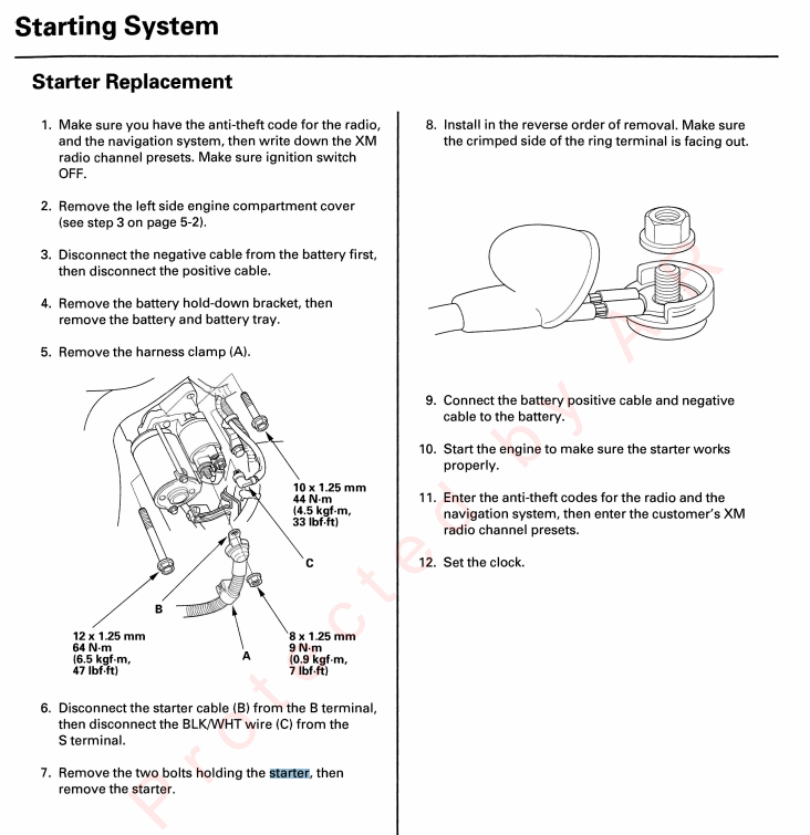

I then removed the starter motor from the engine and noticed the ring connector connected from the motor to the solenoid was loose - loose to the point I could rotate the ring connector and loosen the nut by hand. I proceeded to test the starter motor and it runs fine and feel torquey, albeit unloaded so hard to tell if it was actually good. The starter motor was replaced last year with an after market or rebuilt one and worked fine until I put the car away in March. Also when I tested the solenoid only, the motor also turn slowly. Not sure if this is normal or it's leaking current? Anyway, I put the starter motor back on and tried starting the car again, but same thing - just clicking noise from the solenoid, but engine won't turn over.

I ordered a brand new OEM starter. While waiting for it, I decided to take the old one apart. The motor checked out fine so I cleaned it up and put it back together.
When I received the new motor I decided not to install it, but instead ordered a new solenoid for the old motor. So today I installed the old motor with the new solenoid, but car behaved exactly the same as before - click, but engine won't turn over, not even a tiny bit. When I tried to start the engine, voltage would drop to 5-6v. At this point, I thought maybe the motor is bad so took it out then put that brand new OEM starter on. Guess what, same exact thing... the new one was only able to turn over the engine a tiny bit, like less than an inch. At this point my bro came home so we removed the battery completely and tried with just a jump starter, but same thing. We then tried rotating the engine by the crankshaft bolt again, but couldn't get it to move without also turning the power steering pump pulley at the same time. My bro suggested we remove the belt and see if it starts. After removing the belt, we noticed the alternator was completely frozen - not sure how I missed this because I did look at all the pulleys to make sure they turn freely when rotating the engine manually. Engine started right up on first crank without the belt. Anyway, we removed the alternator and got it unfrozen then put it back on and car start fine now with the old starter motor.
