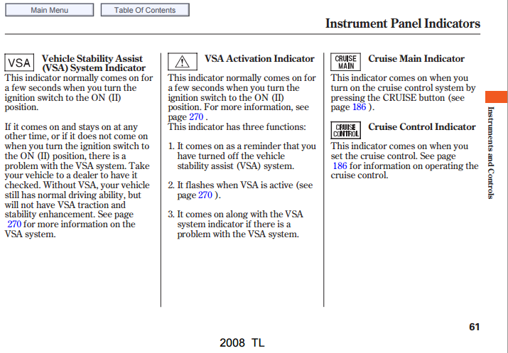

What does the triangle with the ! In side of it mean?

I believe that means VSA, that your traction control is either disabled or turned off, possible a fuse? Possibly you hit the button? The diagnoses is endless.

Might I interest you in reading your owner manual? Page 61 in the 2008 TL manual.

Polobunny the previous owner lost the manual so that's why I asked lol
Acura Vehicle Information | Select Your Model | Acura Owners Site
