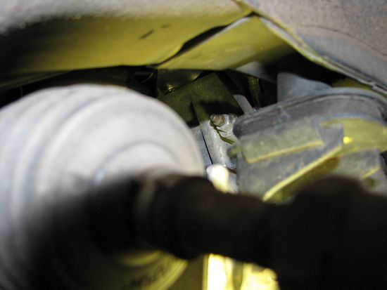

OK since I messed this up by saying the wrong side originally here's a picture that I hope will help.
Blue circle is the drain. Red outline is the sub frame mount. So if you are looking up through the RIGHT side (passenger side on LHD car) then if you look up past the sub frame mount you should see it
In this picture you can see the sub frame mount again but also the boot on the steering rack. So that should help give more perspective as to how/where to look
