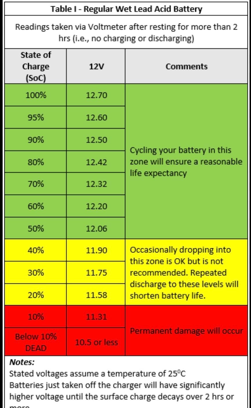

Drove home, 1,6 miles, and check voltage again and it was 12,37. This time car started every time, with little hesitation. I didn't drive at Saturday just started car a few times. Start googling what could be and reading my files in Microsoft words that I'm making along years from 98.. Go check my file about battery and it is there 12,24V is battery is 50% empty.
I connected that it was very cold and battery was half empty. I forget to turn off headlights and it is where battery come to at Friday. Dash lights worked but not headlights and no starting. Pulled out battery at Sunday charged it and when it was full it read 12,9V. It was very cold at Monday morning and night but car started without any problem.

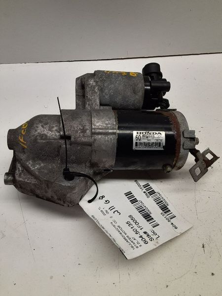

So I drove Acura TL to my parking space. Went to u-pull to bring starter from there but looked original starter, old like rest of car. Found one nice at junkyard that has "Honda" tab on it and it is from Acura tl 2008 and look younger than original part.

Starter that I brought yesterday. It look to me that is aftermarket, not original from car, but is Honda still. Not original from car is good thing, do not want starter that was at engine for 400k. Before I got this one I was at youpull and starter there was original ones because was of same color lake engine and tranny.

Replaced starter with "new" one at Sunday. So far so good. Job is not big but is somewhat tricky as I'm concern. Also one of two big bolts for starter felt down when I was installing it at take me 30-40 min to find it with lifting side of car etc.. "New" starter look better than old one. Definitely need not to remove tray for starter removal.
