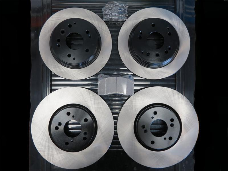

Old Apr 11, 2016 | 04:56 PM
ExcelerateRep's Avatar
Former Sponsor
Joined: May 2010
Posts: 2,228
Likes: 354
From: Branford, CT
We highly recommend our Centric/Stoptech brake packages that include Powerstop rotors and Street Performance pads for all four corners. We've seen a lot of positive feedback over the years on these, and we offer them for both the base TL and Brembo set ups.
http://store.excelerateperformance.c...s/g-63863.aspx

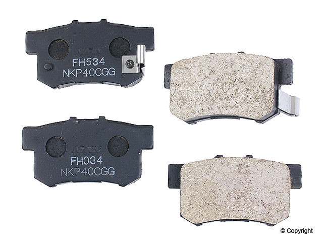

Old Apr 21, 2016 | 01:12 PM
94eg!'s Avatar
#1 Super Guy!
Joined: May 2007
Posts: 2,337
Likes: 512
Originally Posted by ExcelerateRep
I think the conflict is that we're trying to say the Stoptech pads will make less dust and noise than other performance oriented pads and rotors.
What 94eg is saying is that they will produce more dust and noise than oem or ceramic components, which is also true.
They are a quality setup and while everyone has their biases we sell other options as well that also perform great. The Stoptech's are just a great value for the money so we usually recommend those.
Oh yeah, that's a good point I didn't think about. The dust issue could be relative. Stoptech pads make less dust than OEM brembo, but more than OEM 5AT.
Personally I just opt for stoptech pads all around so I get a nice even coat of dust on all 4 wheels! lol I would stick with OEM brembos (or the cheaper Centric OE version) if I could get the same dusty compound for the back.
BTW: There is another interesting rear pad option for the TL. The Nissin aftermarket pads use a compound with higher friction than the original Honda/Nissin rear pads. They are GG instead of FF friction. I always wanted to try those out to see how brake response is effected. To me the TL seems pretty underpowered in the rear. Though I'm only basing that assumption on the relatively slow rate of wear at the back.
Every other pad available for the TL that I've seen has an FF friction rating. Since Nissin designed most of the Honda braking systems, I would definitely trust they know what they're doing by offering stickier rear pads.
