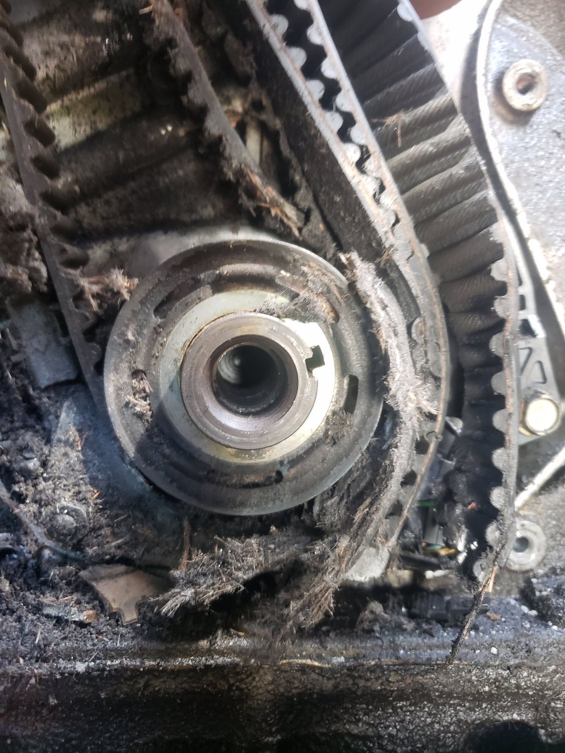

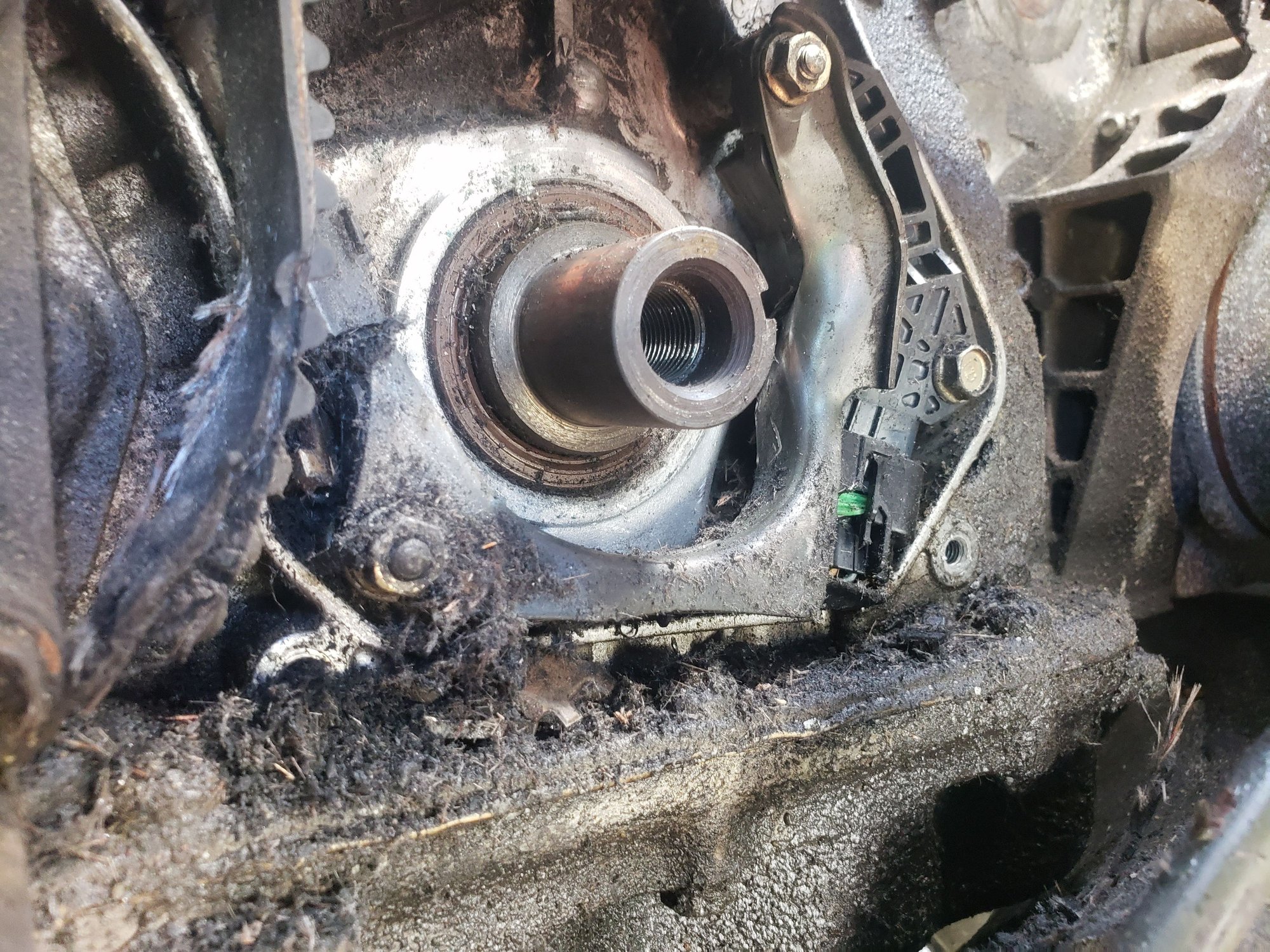

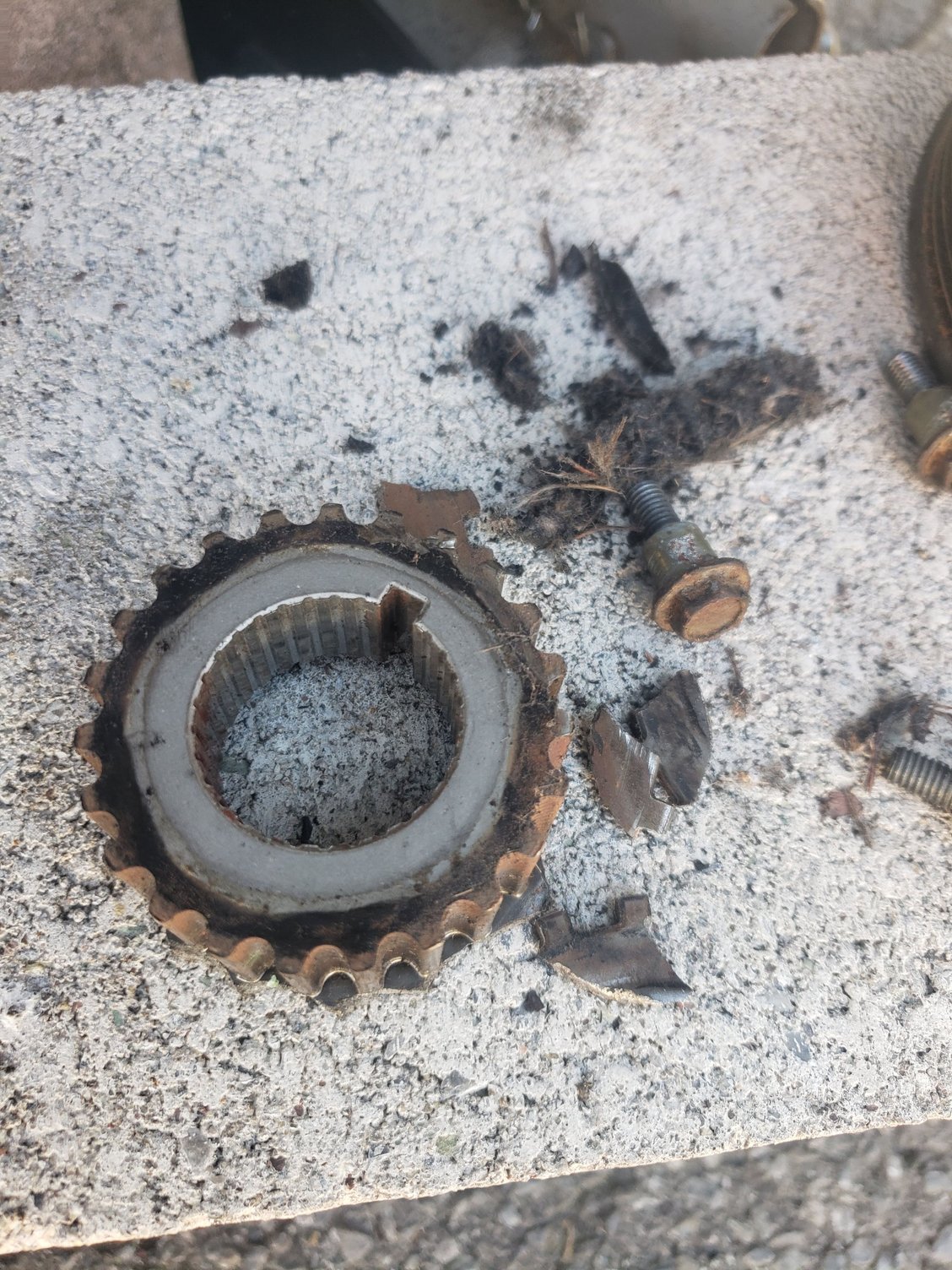

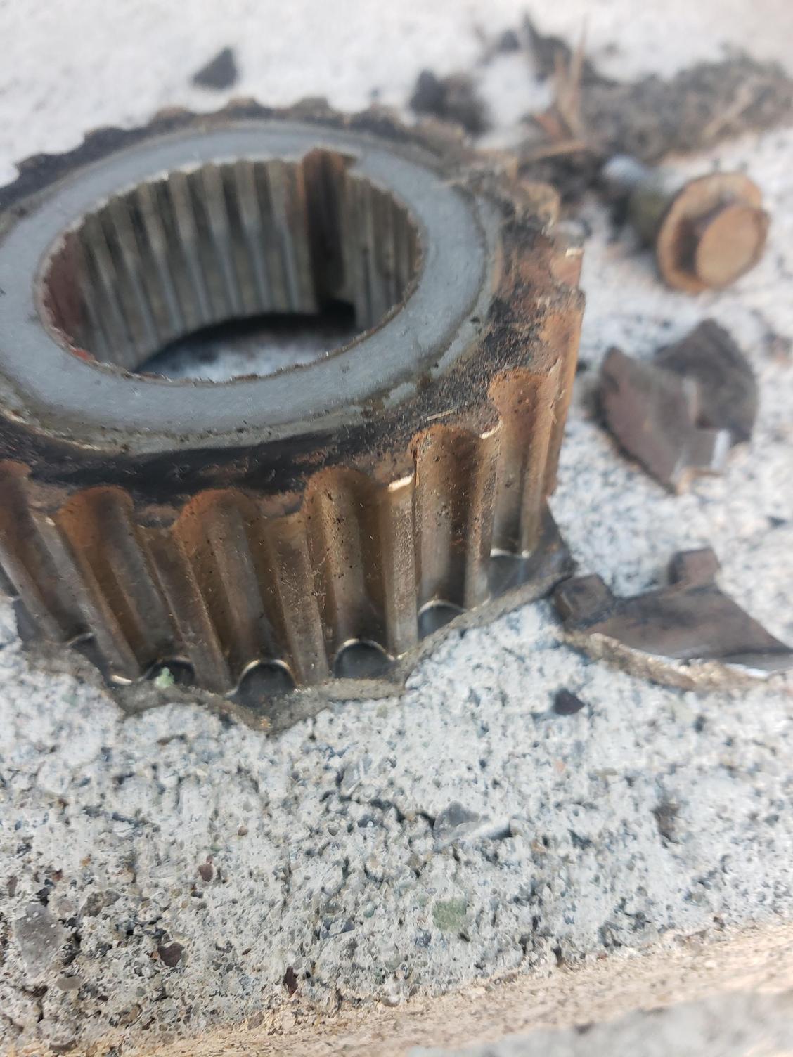

Update! (See images) Finally back from working on the road and to get my hands dirty working on this thing (namely from the leaking valve covers)
Unfortunately, taking off the timing belt covers, I found this mouse nest of a catastrophe. I never thought that a timing belt cold break, and shear pieces off that sprocket in there, damaging the crank sensor, the holder, and the timing belt cover.
Currently, I'm thinking new engine. J35 from a Honda Odyssey as mentioned above. Buying regular gas vs. premium might be nice here in NY State
What do you all think?
Thanks so much

Old Jul 3, 2022 | 03:58 PM
Pair of TLs's Avatar
Joined: Dec 2012
Posts: 2,301
Likes: 1,047
From: SE WI
I would go with the new engine.
Old Jul 5, 2022 | 08:45 AM
TheSauceBoss's Avatar
Joined: Mar 2017
Posts: 842
Likes: 323
From: Columbus, OH
For what it's worth, mine looked exactly the same when the timing belt broke. Granted, the belt sprocket on mine remained in once piece.....I think i had to replace the sprocket plate, the little aluminum shield for the crank sensor (the one in the last pic, it looks like your cps may have survived?), as well as the plastics for the timing cover.
I know I sound crazy, but if it were me, I'd still try to throw a new belt on just for fun. What's another 20 bucks at this point if you're looking at a new engine. I cannot even explain how surprised I was when I did so and my car started up just like new.
Is it useless in your case? Maybe, especially considering what appears to be valve contact on the tops of the cylinders. Never mind the fact that your belt sprocket might not even work properly anymore, or your CPS.
But again, this is as easy as it'll ever be. Disconnect the tensioner, throw on the new belt, reinstall tensioner, make sure the engine is in time (you'll also know you're SOL if you can't rotate the engine all the way around by hand).....and then all you have to do is start it and see. Don't need to reassemble anything, you just won't have alternator power and be running solely off the battery.
Idk. I've also been told I'm a "toxic optimist"

Old Jul 6, 2022 | 12:44 PM
twokexlv6coupe's Avatar
Joined: Jul 2017
Posts: 532
Likes: 159
^^^ I agree^^
It can't hurt to simply throw a new belt on there and hope for the best. Best-case scenario is you had zero P2V contact, and your engine works again. Worst-case (which you're already assuming is the case) is you're in exactly the same boat as you currently are.
I too have had crazy good luck by accidentally installing my Subaru's timing belt with the crank 90* out of time to the cams and attempted to start the engine a coupla times, and once I realized that, re-installed it correctly and that engine has lasted 10K miles @ ~500awhp thus far.
I say throw a cheap belt on there and giv'r hell!
Old Jul 6, 2022 | 02:37 PM
horseshoez's Avatar
Latent car nut
Joined: Jan 2017
Posts: 7,917
Likes: 2,069
I'd be inclined to do two things:
  • New timing belt as recommended above
  • Pull the heads and have the unbent valves refaced and the bent valves replaced, and yes, I am about 90% certain you have at least a few bent valves.
