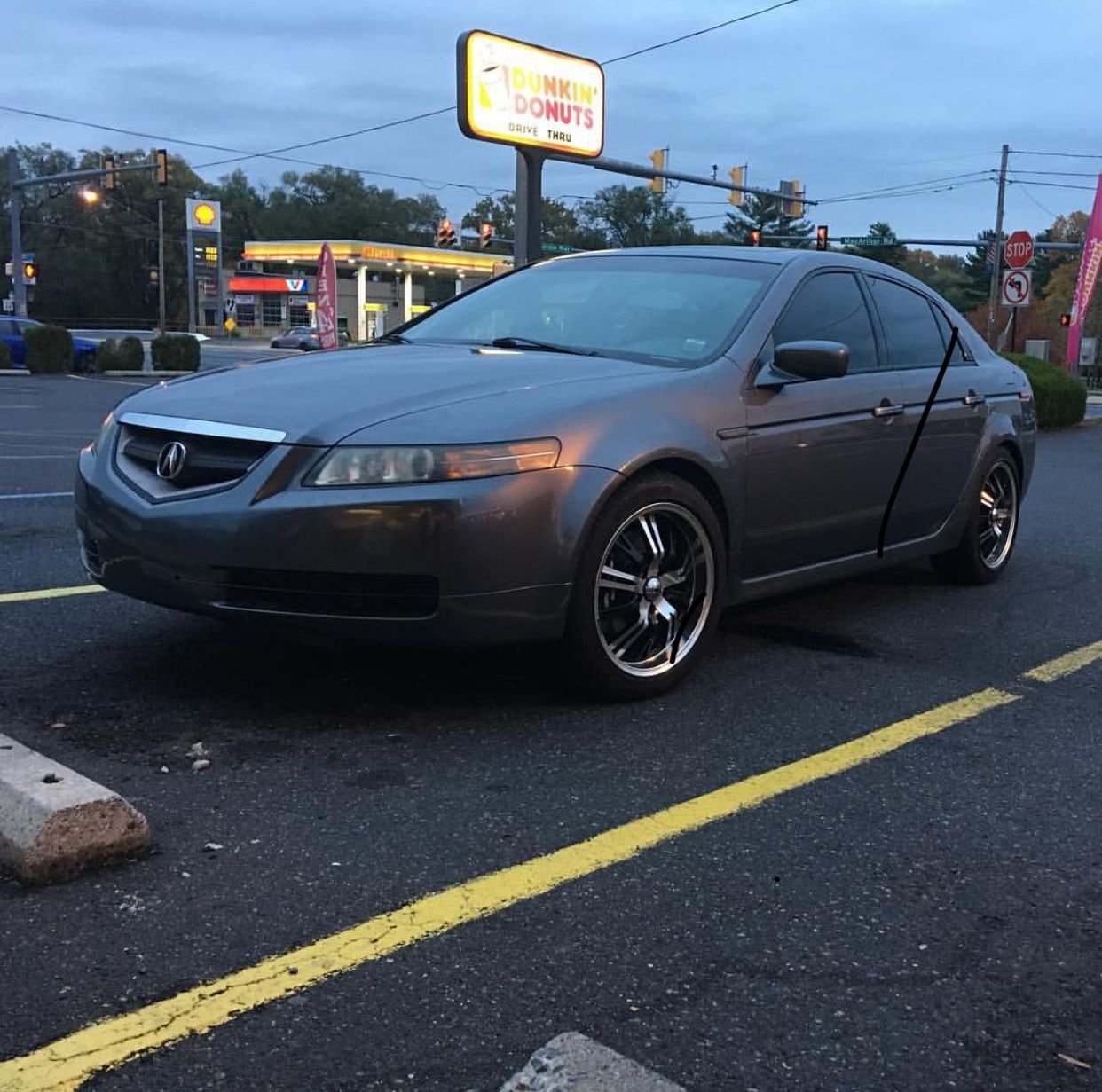

Back with a 05
So to add. I got a 2005 Acura TL with a 3.2. Squashed the j35 idea just stole some parts for use in the shop. Now I’m fixing some problems it has. And getting to the upgrades.
So im considering a cmc and clutch kit+ lightened flywheel etc.Not to sure what would be best. Would like to jump over 300hp. Adding an intake + spacer and j35 intake manifold since it was free anyway. Will do the j pipe stuck between xlr8,rv6,atlp. And any other suggestions I am open too. Please lmk. Rims are back to stock btw.
