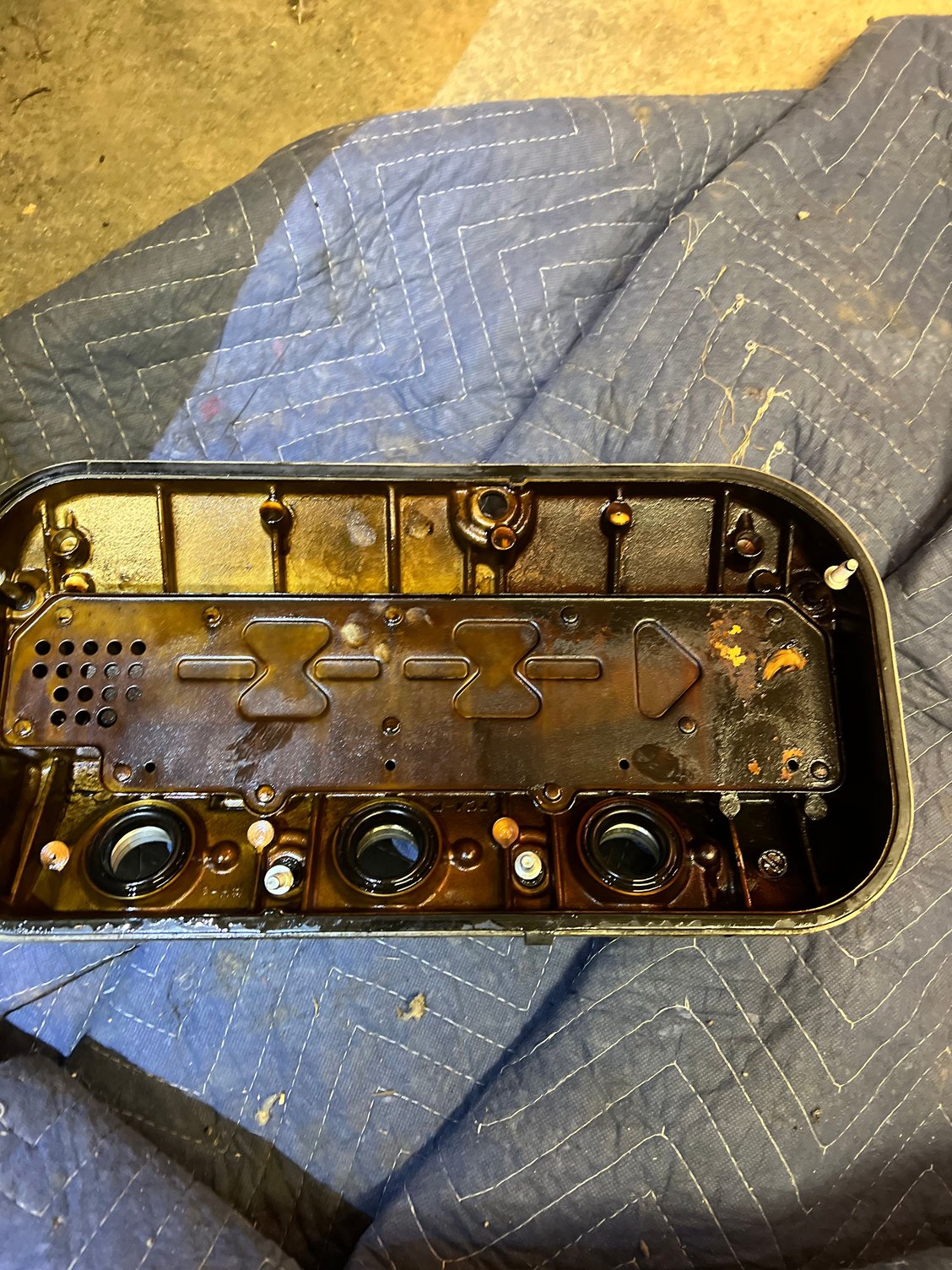

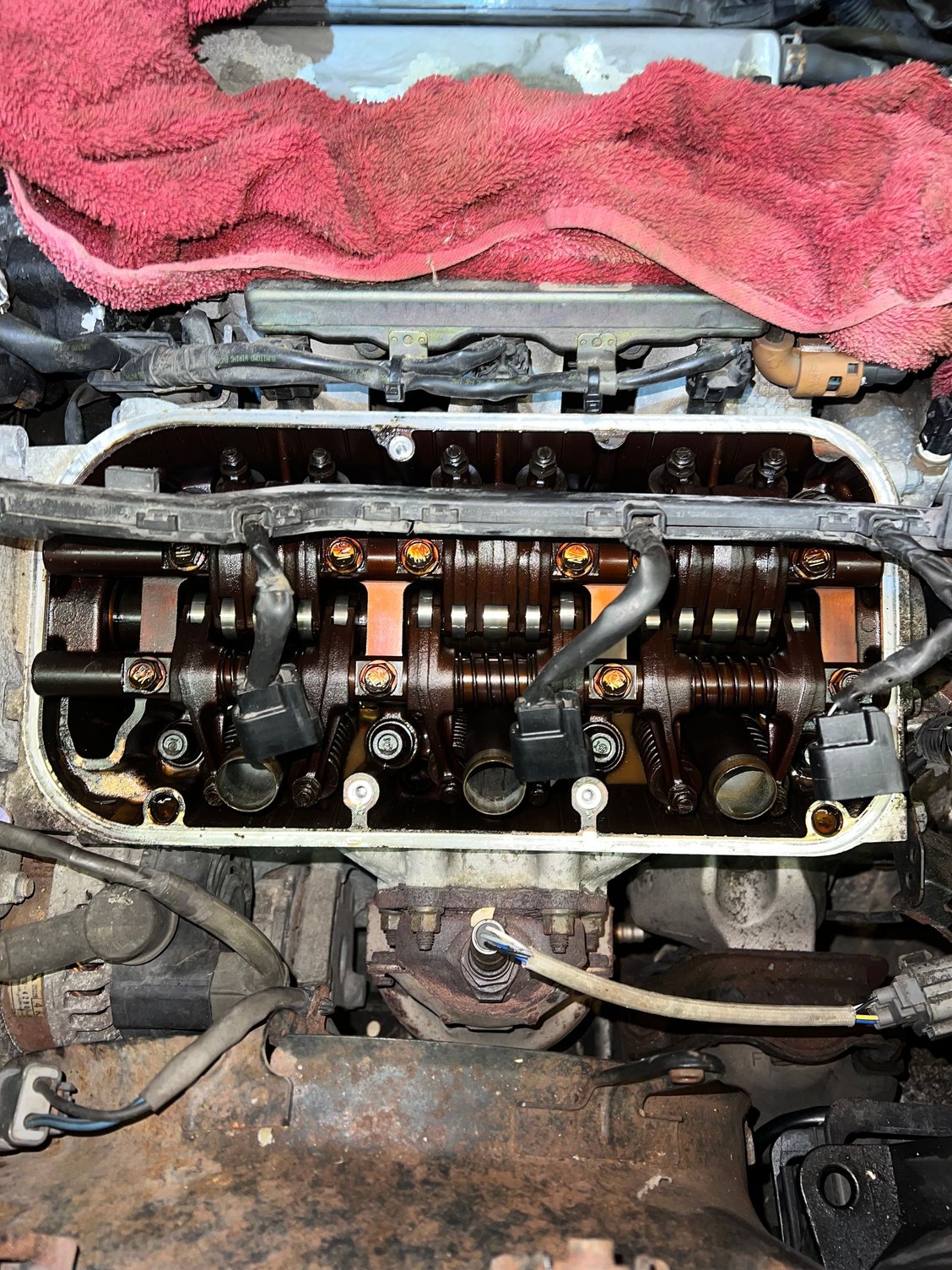

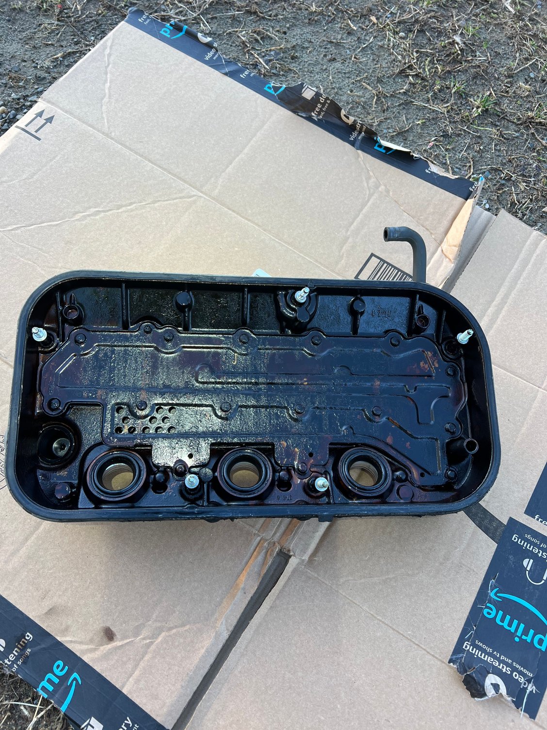

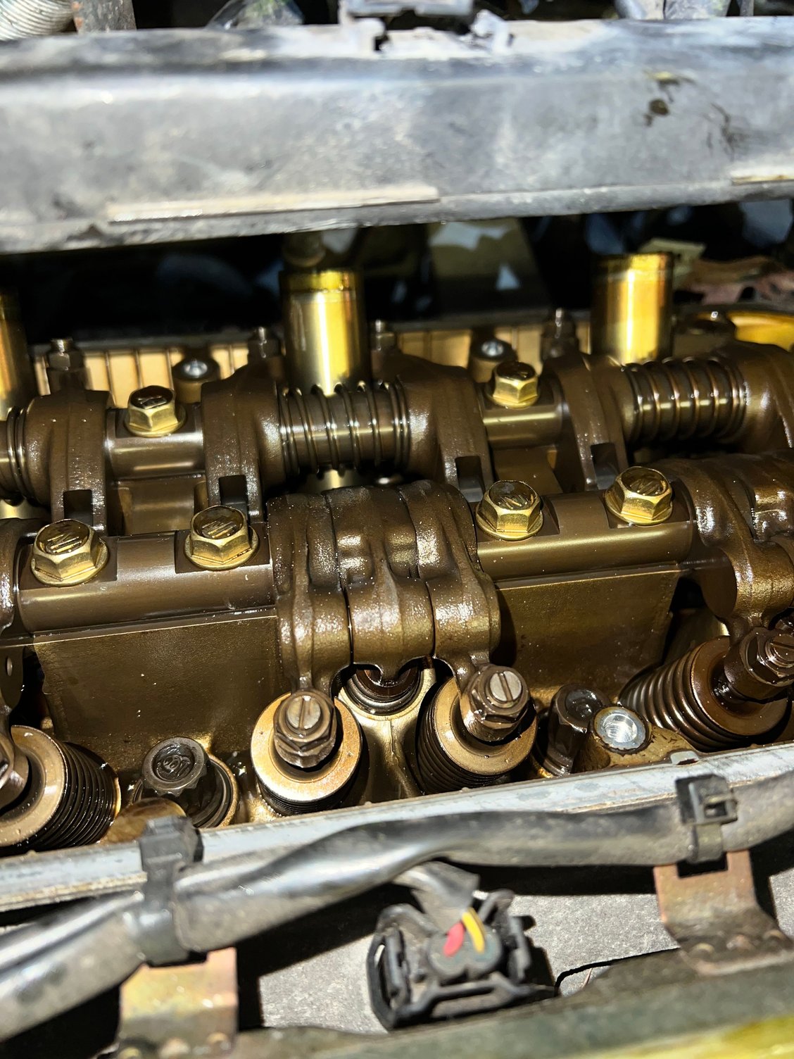

so I finally had some time to take valve covers off and adjust valves. didn't have to adjust much maybe 4 total between the 24. a couple were little tight nothing major though like a few mm, 1-2 were a little loose. I'm not convinced that will do anything. I'm going to get new spark plugs tomorrow and put rest back together see how it sounds but I'm not hopeful at all.
thinking may I get lucky and it is the timing belt tensioner , BUT when this used motor was put in, I'm pretty sure I had my guy do the timing belt too. but I'll check it anyway maybe I'll get lucky.
the front block valve cover was full of caked on motor oil, the rear cover was great and inside engine looked great. the front motor was pretty dark oil on everything so idk. I'll try post some pics of difference.

Engine pics
top two pics are front of engine
bottom two are back looks much cleaner

For a 300K mile engine unless it's had a rigorous maintenance interval and 91 Octane only, I would expect it too look like this. The front engine valve cover will always be dirtier than the rear as the PCV valve sits on top of it and exhausts the by-pass gas out that cover.
