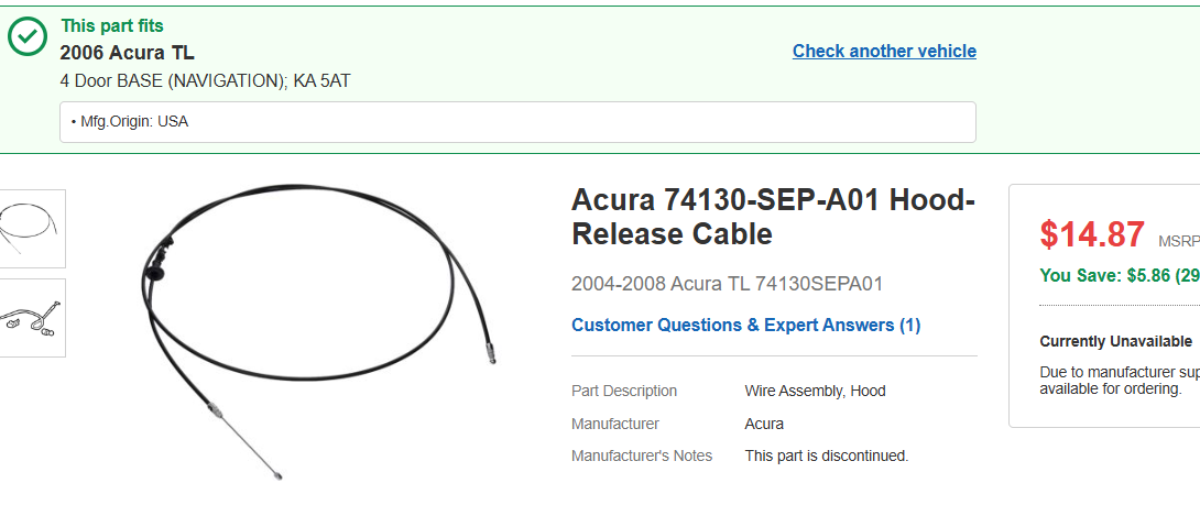

Hello so i'm having a problem figuring out how to create tension on the hood release cable because my hood won't close any help in is appreciated, im not sure if to pull off the fender or if the release has a slide pin i can pull out and retrain it that way
Old Jan 18, 2025 | 06:41 PM
Posts: 6,871
Likes: 2,202

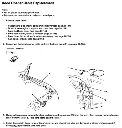

If it is stretched from wear it may need to be replaced? If so, google search the part number below, something should come up.
YeuEmMaiMai
Dec 14, 2013 07:27 PM
Audioserf
Jun 11, 2008 11:14 PM
vthree
Jul 17, 2007 04:38 PM
jaehshim
Jul 10, 2007 09:02 PM
