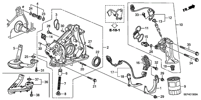

The leak came from the oil pump housing which very common for J series motor. Image below show as #2

Most likely gasket #3 in the diagram on the oil pump. It has been leaking on my Accord, V6, but not seriously.
You HAVE TO pull the oil pan, in order to get the oil pump off.

So I don't need to pull the front cover to replace the oil pump seal, I just need to pull the oil pan and reseal it?
How does the front cover not keep this from leaking externally since this is behind the cover?

You need to pull the lower all 3 timing belt covers, crank pulley, crank gear, oil pan, then you can pull the oil pump off.
