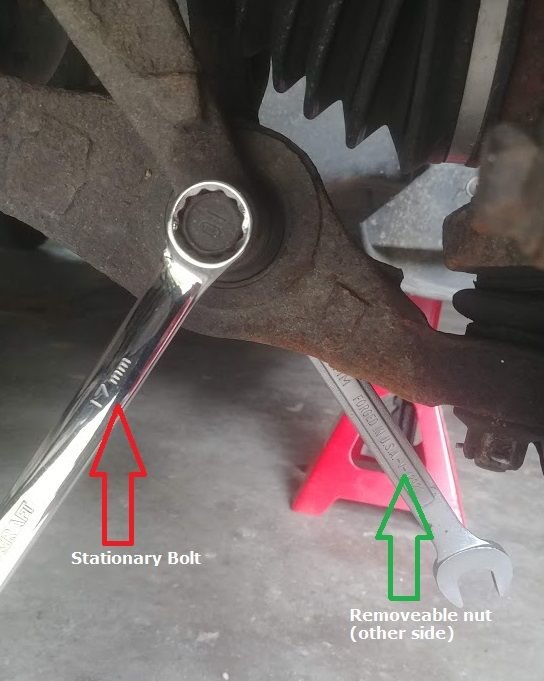

Look behind the brake rotor, and locate the suspension fork. Use your 17mm tool here. I personally had two 17mm wrenches (one to hold the stationary bolt, one to remove the nut) at this point.
Crack and remove the 17mm nut on the rear side.
The bolt is now exposed. Use a punch and a rubber mallet to punch it out. This may take some force.

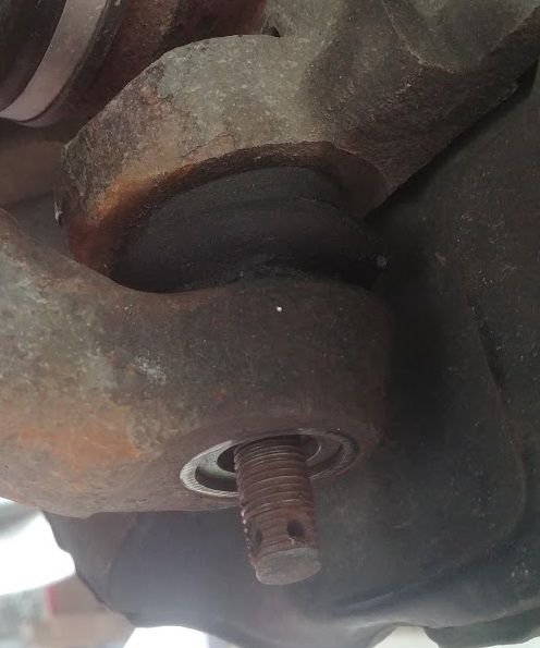

4. Remove the castle nut and cotter pin from the ball joint.
Removing my corroded cotter pins held me up significantly. I doused them in pb blaster and used needle-nosed pliers to remove them, after much frustration. Straighten the pin as much as you can, and be sure to stay straight when pulling it out. The castle nut also uses a 17mm. Fortunately, since I replaced my drivers side axle just a few weeks ago with a temporary ebay one, the new cotter pin was easy to remove this time.

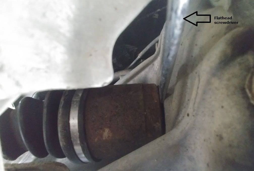

Now, you need to get underneath the car. It is necessary to remove the transmission splash guard. I did not document this process, as it's a couple bolts and a couple clips that need to be removed. It's the same guard you remove when you are changing the transmission fluid.
Once removed, you will be able to look up at the axle where the joint connects into the differential. Use a flat head screwdriver (or other prying tool of your choice) to apply force to the inboard joint of the axle. Be sure to only pry at the outer lip, if you get too deep towards the center of the shaft, you can damage the seal. When prying, use your other arm to pull the axle shaft straight outwards. It takes a second to get the hang of, but it's relatively easy to pop out.

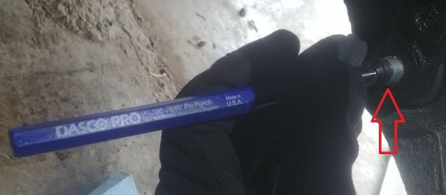

Use a punch to deform the nut into the groove like so.
