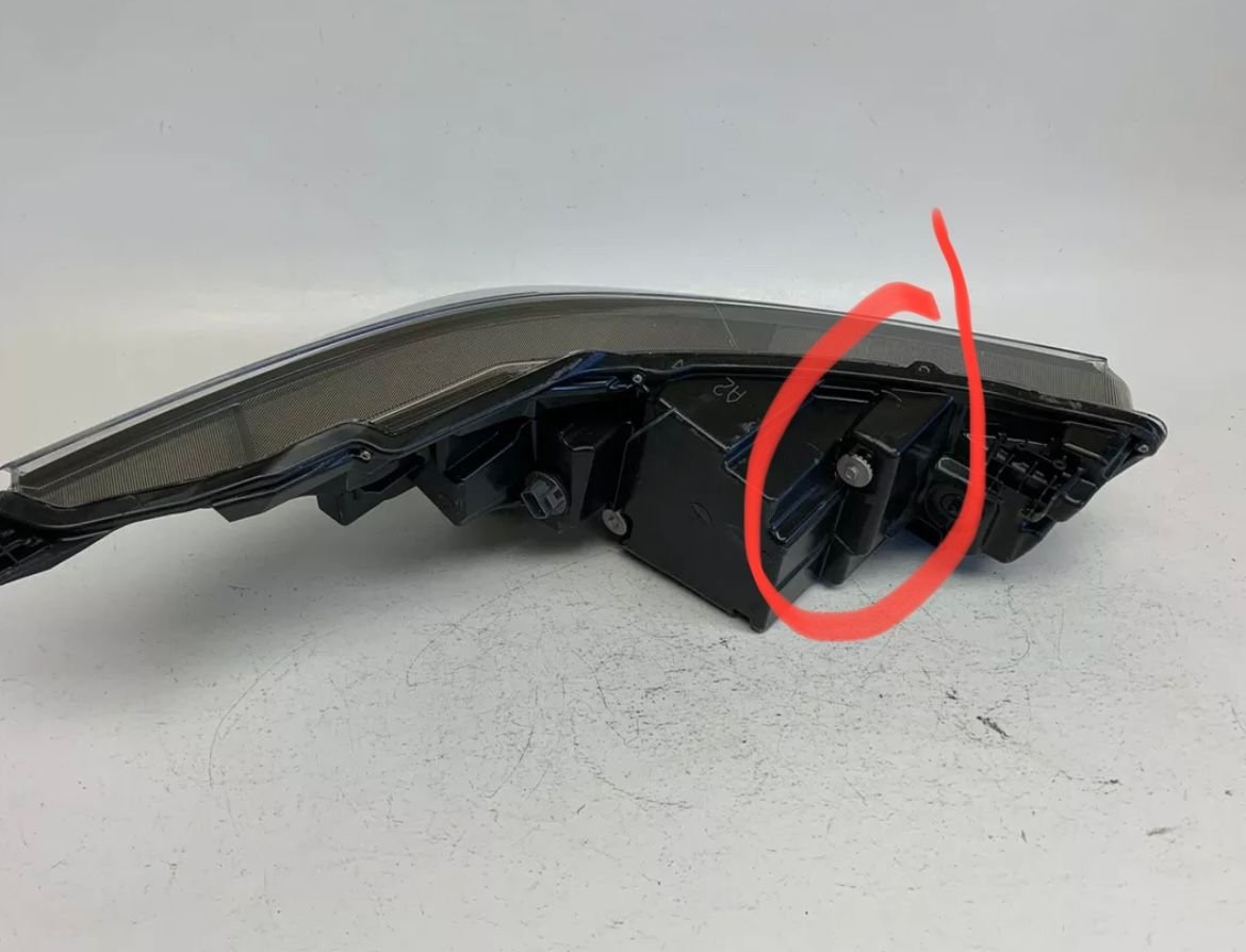

you turn the adjustment screw
I believe there are two but just tagged the pic quick

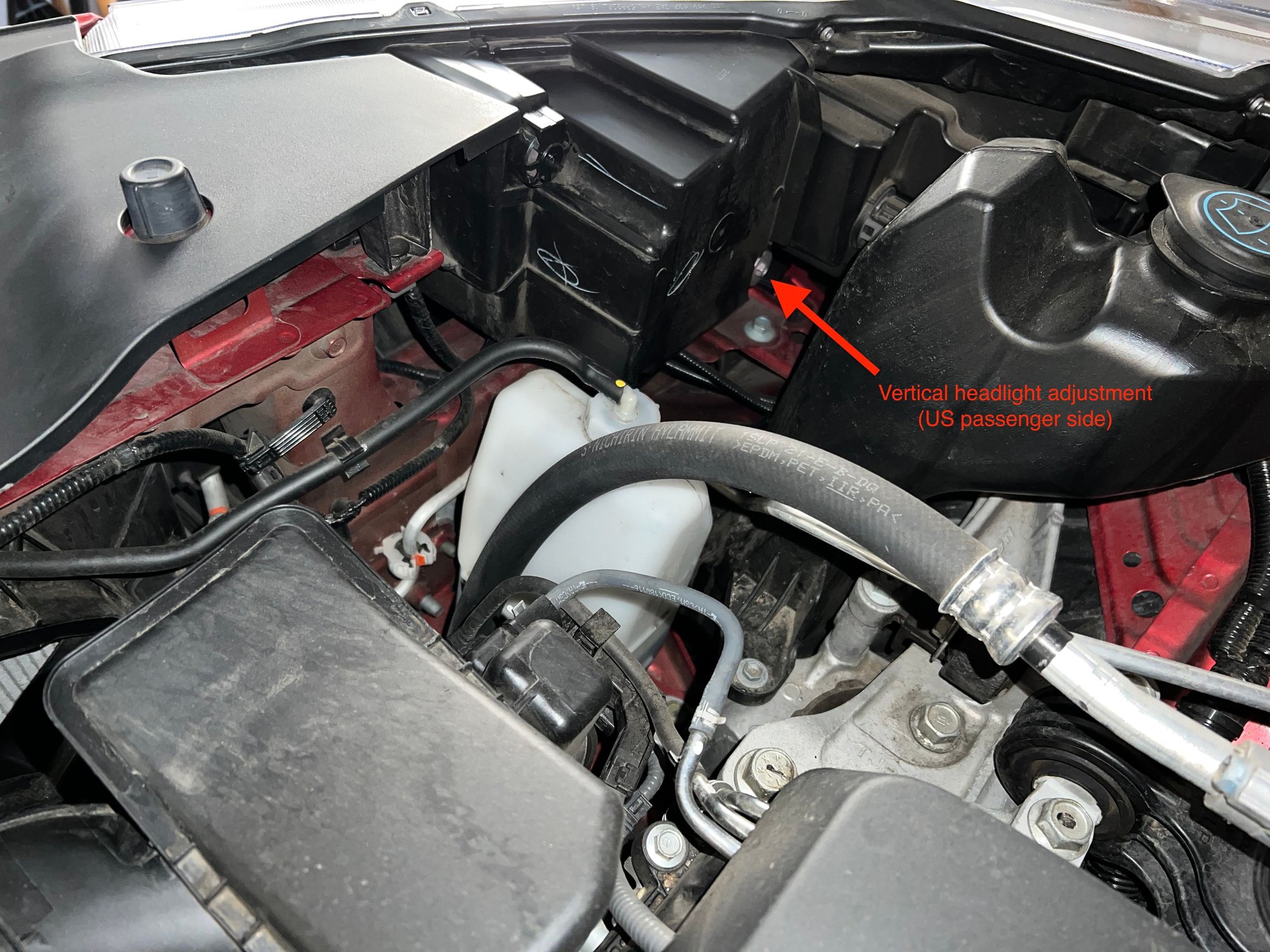

There are adjustment bolts accessible inside the engine compartment located near the center of each headlight assembly. Start with the one on the passenger side (US), as it's the easiest to access - see attached photo. The other one is in the equivalent location on the other side, you may need to move some items out of the way to access depending on what tools you have.
RDX headlight aim adjustment

There are 2 adjustment bolts, one was indicated in the picture and another one is on the top and is covered with a plastic cover. Which one is for adjusting high beam? My low beam seems to aim right but the high beam is a bit too high. thanks
