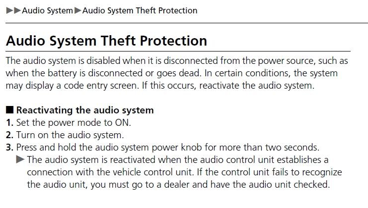

This is from page 242 of my 2020 Owners Manual.
It sounds like, when you push and hold the power button on the audio system, the unit compares it's internal code with the code stored in one of the vehicles control units (probably the engine control unit). If the codes match, the unit knows that it is connected to the original vehicle, and unlocks itself,
There must be a way to enter a code manually should you ever decide to sell your audio system to another RDX owner, but I have never found the answer to that problem.
