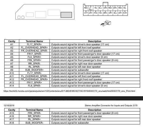

I recently came under possession of a new RDX A-Spec. One of the first orders of business was to install aftermarket woofers (casual eardrum requirement, really). But instantly I was met with noise coming from the subwoofers which I identified as coming from the ANC module (which I unplugged, and the sound went away)
Fast forward to today, had to take my car in for a water leak and they gave me a loaner, conveniently a brand new RDX A-Spec. Now that I’ve had my car without ANC and walked into this car, I realize I like it enough to want it but I want to find a way to have both my woofers and the ANC.
Has anyone done any work figuring out which wires are the outputs from the ANC? Perhaps it would work out to put the equivalent of a subsonic filter (or WHY) on those wires alone. (yes I realize you would lose some of the ANC functionality).
T other idea I thought of was to feed the subs directly from my phone and then split that feed to the headphone jack. I don’t really care for this idea though because I prefer to use the CarPlay functionality. (Unless there’s some way to play over USB and using the headphone jack on my phone concurrently).
Let me know your thoughts? Perhaps someone has a pin out for the ANC and with that I can do some prodding and see if I can filter out those generated frequencies, or ideally dampen them enough that theyre still functional but don’t turn my woofers into 2 12 inch engine noise machines...

I’ve wired in an lc2i, off of the line to the subwoofer. This feeds my amp and subsequently the aftermarket woofers.

Yeah,
There have been other posts/threads on this subject which I have responded too also.
https://acurazine.com/forums/third-g...r-pain-981862/
Looking at the schematics, I put a switch on the yellow (power) line to switch it on and off (pin 11).

I just finished my sub upgrade this past weekend and am not having this problem. I pulled the signal from outputs A9 (Sub +), A18 (Sub -), A7 (RR_Speaker -), A17 (RL_Speaker +) into my amp. No LC2i in my case because my amp has that built in. Same logic though. Could you have spliced into the wrong outputs? Also make sure you're crossover frequency is set to around 100Hz and your gain isn't set too high.

I pulled from RR- and RL+ for a mono signal. I considered the fronts but decided on the rears. Perhaps the fronts or the center channel would have been better but everything sounds fine. I played some frequency sweeps and familiar songs that make use of soundstage to ensure everything sounded balanced, and it does.

Gentlemen, I guess what I am getting at is that I want the full functionality of ANC without any buggy feedback. Now that I have acquired the pinout for the ANC, I can see there are 4 output wires. If I can probe these output wires and see if it’s literally a raw sound signal, I may be able to remove the affected frequencies using a filter of sorts. This way the rest of the ANC still works but there is no output at my desired subwoofer frequencies. This assumes that the audio from your device is sent to the amp and the ANC input is sent to the amp and then the amp muxes the two signals to provide your final speaker outputs. Do you see what I’m getting at? I know some people do and some people don’t have issues, right now it seems that the lc2i is somewhat of the culprit.
on another note, why are you guys pulling from any speaker other than the subwoofer for your input only to cut it off with your amps filtering? Unless I’m missing something, I’m really only interested in the sound signals meant to go to the oe subwoofer and adding anything else would just be pointless.
