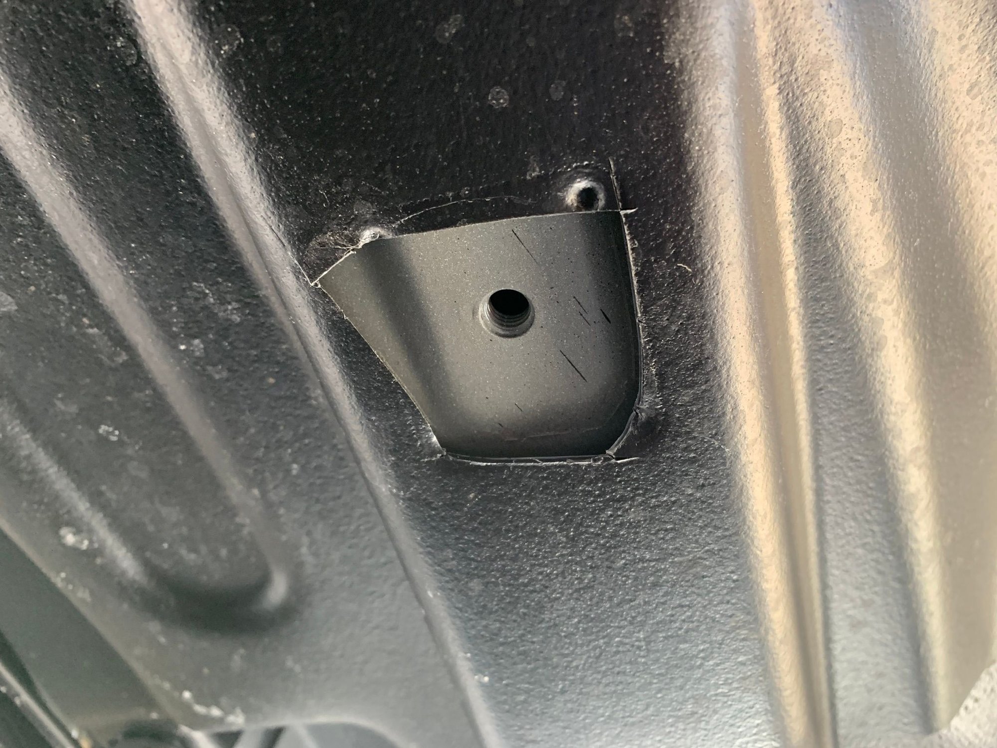

I did the install myself. Bought the running board for $550 and saves almost $500 from dealer labor.
It took me an hour to install because I was extra careful. I had to cut out out holes in the plastic molding.
I will upload a few pictures.

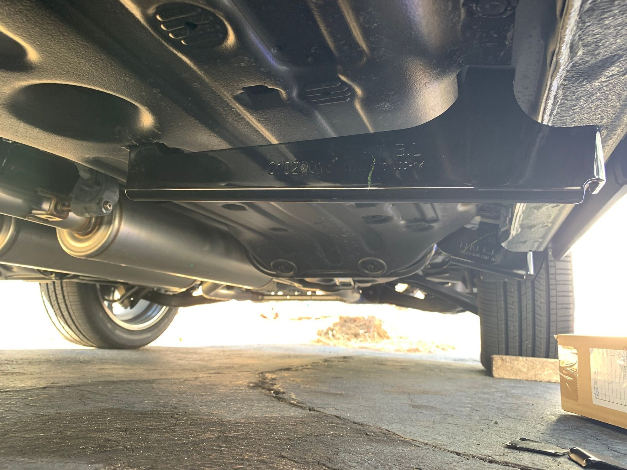

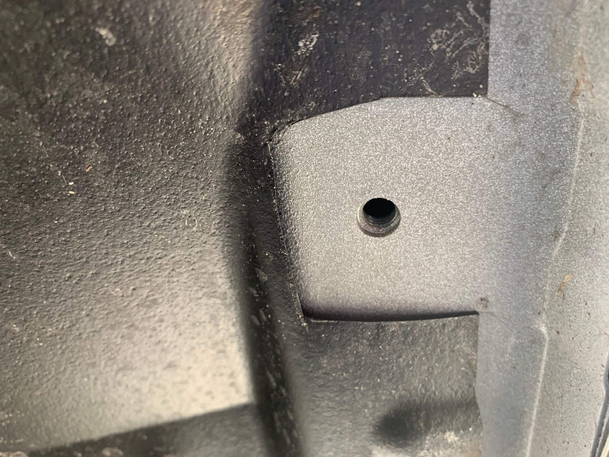

Running board pics. I didn’t remove the plastic under cover. I use a sharp knife to cut around the perforated square.
Cut around the line

Awesome pix! So the cutting doesnt seem to bad. You would say its pretty easy to do...cut and bolt on?
Nicely done!! I'm sure others will appreciate your pictures.
Yes, installing the mount brackets was the easy part. As for the cutting just take your time with a sharp box cutter. Make a few small cuts around and slowly go around it. I was rushing so the cut wasn’t a square as you can see😄.
The hardest part was mounting the running board over the brackets. I did it all by myself. Get someone to hold the board level or get a small stool to rest it on. Do not over tighten the bolts. Leave it a bit lose so you have wiggle room. Once everything is in the right place and mounted tighten up the bolts.
Good luck!!
