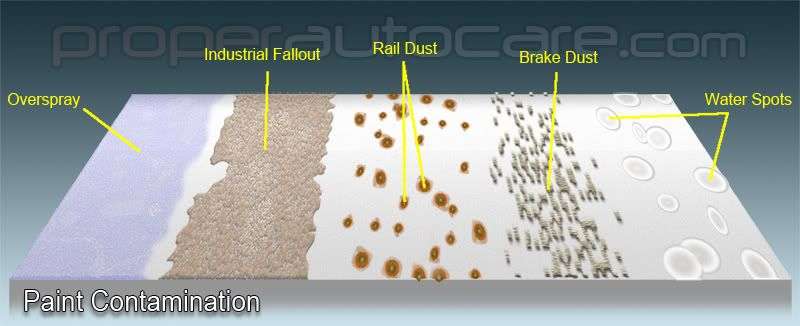

Does ceramic coating protect the pain from brake dust? I have a white A-spec with 2000 km on the it, and yellow brake dust burning through the clear coat has started bothering me. I'm thinking if ceramic coating stops the clear coat damage I might do it. Any experience?

Are you sure its brake dust? I haven't heard of any "Yellow brake dust" before.
Anyways, consumer-grade ceramic coatings (DIY) are generally 9H hardness which should help protect car paint. I have it and its working fine so far.

I most likely used the wrong term. What i see on both of my white cars is probably called rail dust. It could be metal debris from rotors that penetrate in to the clear coat and rust. They can be buffed out easily.
I'll get the ceramic coating done.

Won't protect from chips, maybe help with minor scratches from carwash swirls and etc,
