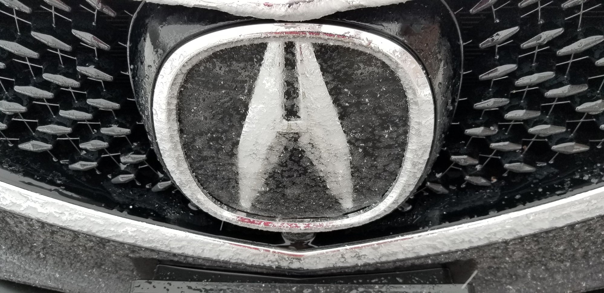

Radar obstructed by slush
About a quarter inch of soft clear slush will deactivate the radar.

Prior to the warning shown in my first post above, the first warning that there was a problem was a front proximity alert and suddenly a BRAKE warning in the hud. Fortunately there were not any cars ahead of me so I didn’t react to the BRAKE warning. Within a moment or so the proximity alert stopped and the warning pictured above came on. The experience made me feel like I was a pilot focused on malfunctioning gauges during an episode of Mayday.

I don't think they had a lot of choice as to where to place it. Obviously it needs to be placed on the front of the car, and I suppose covering it with the Acura logo is the best way to hide it.
Radar systems are systems are "relatively" new, and I don't think this problem occurs frequently enough for the manufacturers to worry about. In fact I would be surprised if any owners would even report it occurring, since the owners manual warns owners that it will occur and it's not a problem requiring repair.
I live north of Toronto, and I only had the warning appear about twice in my 4 years of owning my 2016 RDX and about twice in 1.5 years of owning my 2020 RDX.
Radar uses radio signals in a frequency band known as "microwaves". Microwaves are absorbed by water. That is why food gets hot in a microwave oven, and the glassware doesn't. That is also why you will lose your satellite TV signal during heavy rains, and your hiking GPS wont work when under a heavy tree canopy. What is interesting is that microwaves will pass through ice with very little absorption.
Regular water droplets will run off the Acura logo and not build up enough to cause a problem. And since crystalized water (snow and ice) will have minimal effect, it is only that "perfect storm" that causes the problem, a really wet slush as shown in the first post.

This will do it.

Don't get too cocky about it. The way things are going, this could be your year This was actually the 3rd time it happened since I've had the car. And we live in Kansas!
