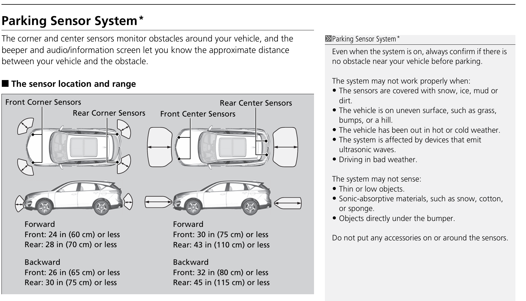

dynaglide - Please see below and hopefully this is a more helpful.

Dynaglide - I feel your pain. I sure was hoping to see the "answer" everyone reading this thread wanted to see...That was a great post that NBP04TL4ME had explaining how to turn OFF the sensors so they won't beep...I also did a search on this thread and only found 3 references to the word BRAKE..and none in the included MANUAL piece...albeit I think that turning off the sensors could prevent the mitigation of applying brakes(IE not allowing you to back out of a parking place) BUT nothing being mentioned seems like that might not be the all inclusive answer that you are looking for. I plan to get a hitch installed and have run into this issue with another vehicle...I believe I told my spouse to go RTFM and I will never do that again. I wish there was a way to remove the non-constructive answers as it makes me not want to use the forums to help solve issues that don't have a clear cut, black and white answer...and without users like us, there might not be a need for forums and the like. I see these same kind of challenges on other types of media.
