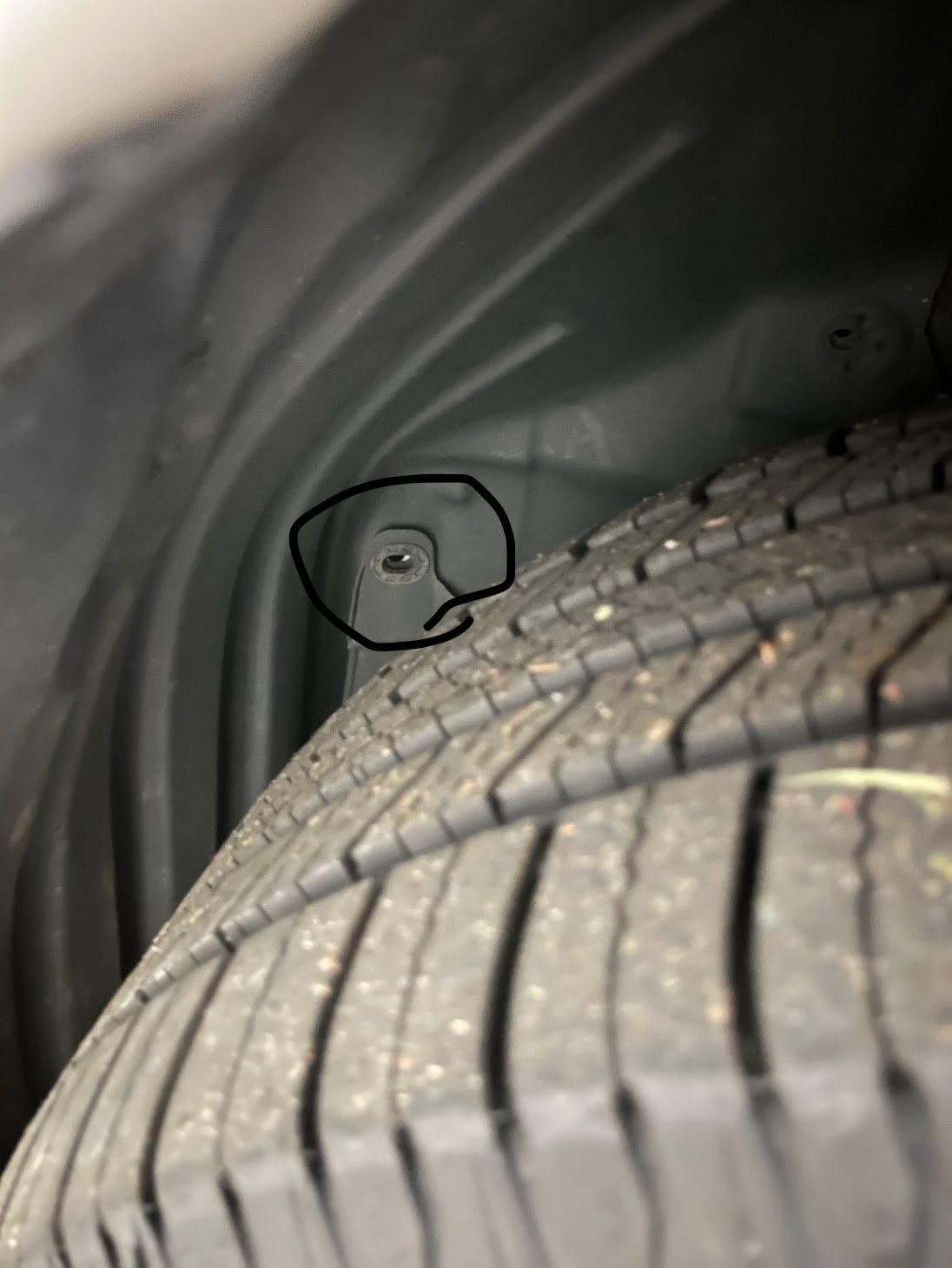

I'm missing one of the front wheelhouse liner clips on my 2019 RDX. Does anyone know the part number for it?

It might be - 91501-TR0-003

Check Fender Liner Retainer Clip. P/N 91512-SXD-003

Turned out the part number is 91505-TM8-003.

Just get an assorted box on Amazon, fender clips dont need to be OEM

Well that P/N is called a Honda bumper clip. The reality is there are dozens of these clips and for the most part three things matter, the diameter of the shank, the head diameter, and the length needed for engagement. I’ll also provide a tip based on an instance where I needed a clip. I pulled into a local body shop and the shop manager provided the proper clip within minutes. He wouldn’t accept any payment.
