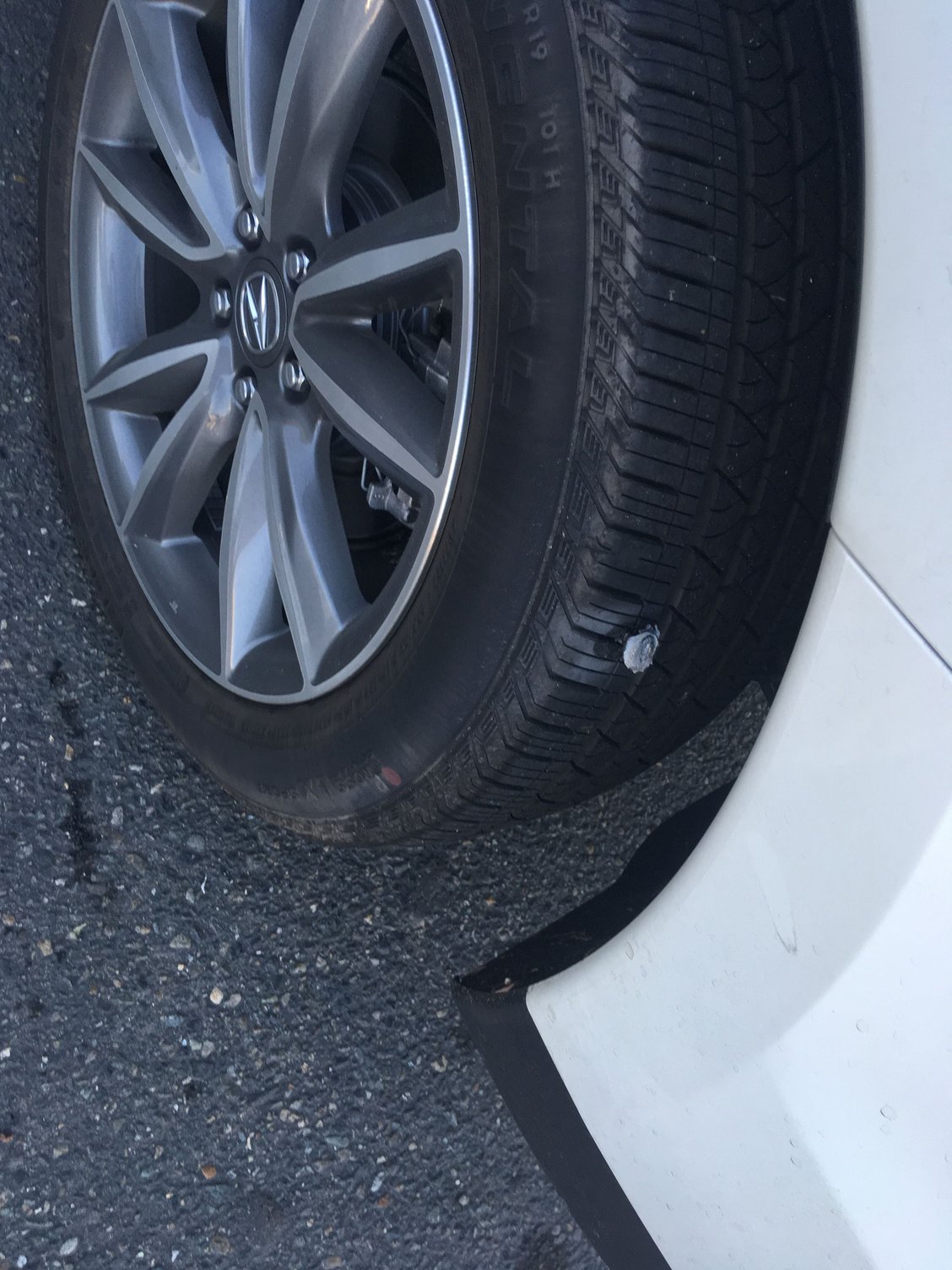

Driving down the highway today I heard a funny persistent noise coming from the rear and couldn’t figure out what it was. Shortly after the TPMS came on and I realized it was due to a flat. I checked the pressure and it read 29 while the others were all 34. I kept driving and watched it drop to 26 so I took an exit and stopped at a strip mall. I called AAA and the automated interface was so bad I hung up after a few tries and called Acura roadside assistance—found the number at the back of the manual. Much better than AAA and they dispatched a AAA service truck! The guy replaced the tire with the donut spare.
I have a few questions—
- I was told not to exceed 50 mph on regular roads and 55 on the highway. But I forgot to ask about distance. What is the maximum distance I can drive on this?
- Should be buying a new spare as well? I assume so. Better to get it at the dealer or doesn’t matter?
- The nail was pretty big so I doubt the tire will be repairable (see pic). Should I buy a new one of the same type ($250 installed from my local America’s Tire Co.) or use this as an opportunity to replace the OEMs?

My understanding is any puncture up to 1/4" can be repaired so long as it's in the tread area which it looks like your is. Have a reputable shop look at it before deciding to replace it - unless you really want to swap out all the OEMs.

THe nail looks to be kind of close to the shoulder so might not be repairable if it's not in the steel belt

Since the nail is in the tread; inboard of the sidewall, I think they should be able to fix it even though it's a big one.
I had a similar nail in a tire on my old Accord.
They repaired it for $15 and I drove on the repaired tire for 30K miles with no issues at all.
If, however, you want to use it as an excuse to get a better set of tires, I wouldn't think of trying to dissuade you. :wink:

When I stopped in the strip mall, there was an off-road wheel/tire store there. I asked them to take a look and they were the ones that mentioned it's not repairable. But they said it would be better if someone that is capable of replacing it takes it off and makes the call on that. So I called America's Tire Co. and had them order a replacement which they said they expect to have some time tomorrow.

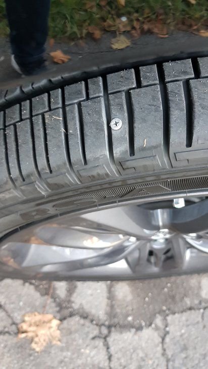

Here's mine a month or so a go, bring the car to the dealer, and they check told me that they will replace the tire under warranty if they unplug the screw and found the tire damage, luckily the screw doesn't go through all the way, so it's ok, but my point is you should check with your dealer first, before decide to replace the tire your self..oh by the way I didn't buy any extra warranty to cover the tires..

I called my local dealer and talked about it. The SA said they don't cover punctures, but if fixable, they would do it for free. Otherwise, I would have to pay for the replacement. Their cost for the tire & labor is about $40 more than America's Tire Co., but they'll wash the car and vacuum it while it's there.

ya that's really too bad, they told I am cover whether it puncture or damage..

I got it replaced today at the dealer. They confirmed that it couldn't be repaired. They matched the price of America's Tire Co. and I got a free car wash.
They said the spare is still good. The parts guy looked to see if it had any mileage rating but it didn't.

I had a screw in my tire that was a little closer to the edge of the tread than Yotrek's and my dealer was able to save the tire. Went ahead and put a new one on and just kept the saved tire. After that incident I plan on getting the spare tire kit for my A-Spec. Rather have the inflator and a spare for what ever happens.
