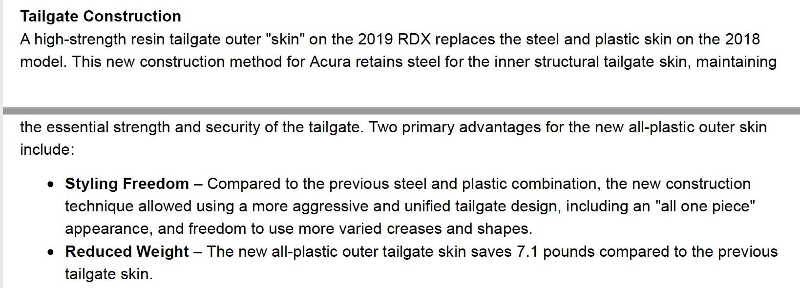

The rear hatch cover is composite ( plastic ). From the Acura press release:
So it looks like Acura tried something new again and didn't get it quite right on their first shot releasing it to the masses. Seems to be a recurring theme.

I see no reason to question the PDR professional's assessment on the lift gate "dimples". Filling in, smoothing and painting the area may be the only viable solution aside from replacing the entire lift gate. And if my experience with relatively minor bumper damage is any guide, that's gonna be a big expense for someone. From what I can see, it looks like Acura sells replacement lift gates as an assembly, so replacing the "skin" may not be an option.
Here's another blurb on the issue:
https://www.repairerdrivennews.com/2...teel-tailgate/
Personally, I would leave well enough alone. As noted, the dimples aren't very noticeable except when the light reflects off them just right.
[edit] I doubt shipping restraints are an issue. Those attach underneath the vehicle.

Not to mention that with the hatch being plastic/composite, it would be very difficult to match it even from factory, let alone after the fact.

The best fix is probably to replace the entire composite peice with a factory pre-painted OEM part.
But they may not be available pre-painted from the factory. I don't think the front bumpers for 3rd-gen RDX are, and I'm not sure about rear bumpers either. IIRC pre-painted rear bumper covers are available for some other Honda/Acura vehicles.
BTW, apparently the "plasticizer" that gets mixed with the paint for application over composite panels is responsible for a color shift.

The indentations you see may be from the outer panel being over tighten, there may me fasteners or rivets molded to the outermost liftgate panel that are too tight and that is why you see the indentations. Have the dealer look into it, it may be as simple as loosening the screws slightly to relieve the pressures.
