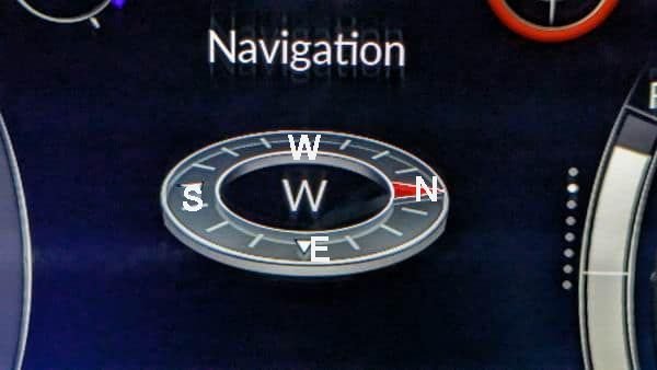

If your RDX is equipped with a GPS based navigation system, then the compass direction is derived from the the GPS satellites. It is not based on the magnetic fields of the earth, like a hiking compass, and therefore does not require any type of calibration.
I think you may be misinterpreting the display, which I have seen others do in the past.
If you look at my image below, you can see the red arrow pointing towards the right side of the compass. Most people are familiar with maps, where the top is always north, and right side is always east. Because of this they assume (that in my image) that the red arrow is showing that I am heading east. When in fact, my image shows that I am heading west, like the "W" in the middle of the circle indicates.
The reason for the confusion is because the red arrow is not pointing in the direction you are travelling, but it is always pointing "north". In my image, I am travelling west, so "north" would be on my right side, and that is why the arrow points right when travelling west, and it points left when traveling east.
One other point about GPS based compasses. GPS navigation cannot tell what direction you are facing. GPS detects where you are on the face of the earth every 1-2 seconds. By looking at where you are now, and comparing that to where you where 1-2 second ago, it can then determine what direction you are heading. If you try to test your compass by driving in tight circles, you may find that it won't move, because the GPS system hasn't been able to detect any significant movement across the earths surface.

My time to edit the previous message has expired, but I wanted to illustrate what I think would be a less confusing display. Basically make the compass look more like a real compass by adding a few letters.
