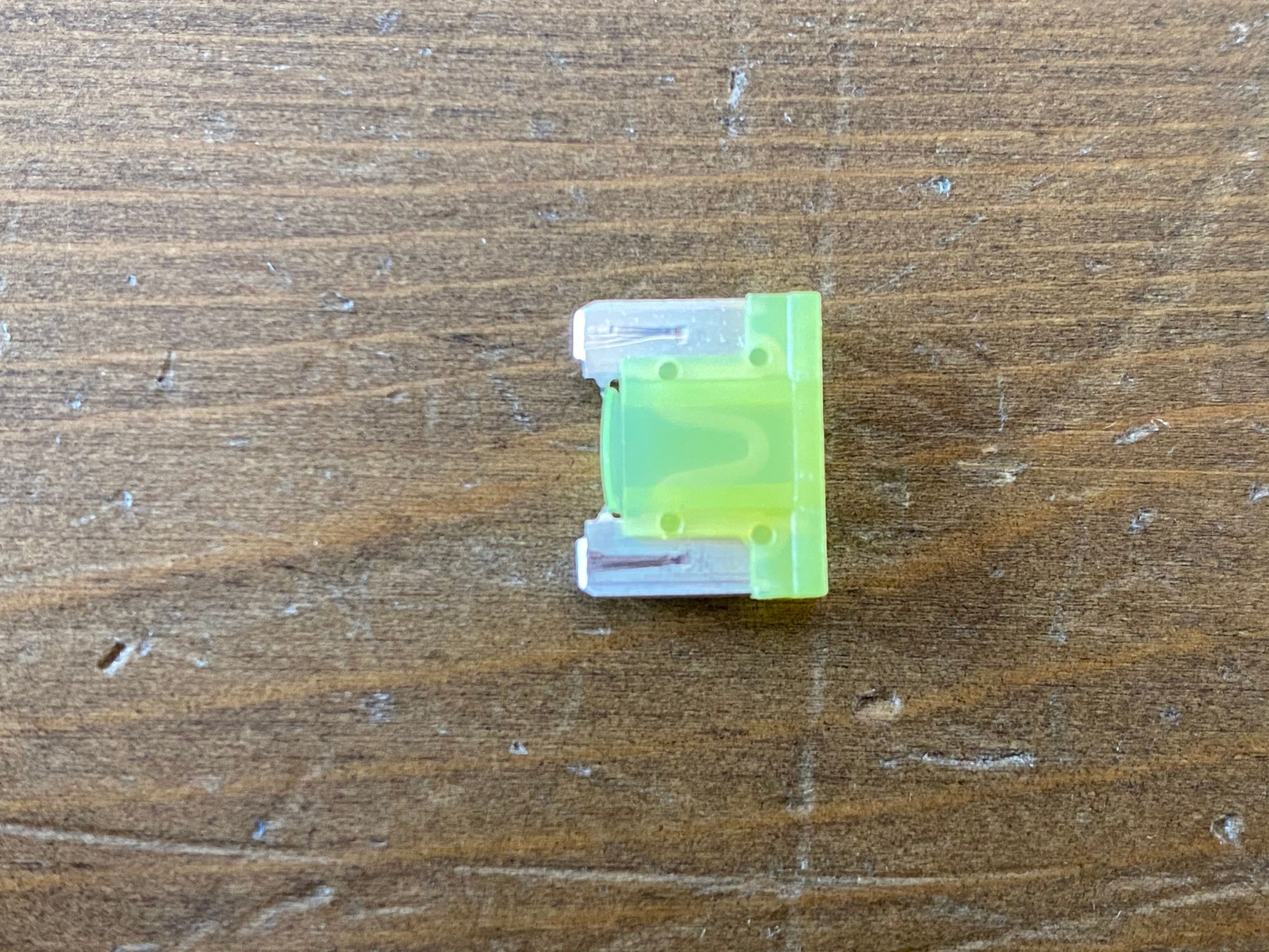

Since the fuse didn’t look blown to me, I decided to take a picture of it and swap it back into the car this morning and test the passenger side power window. The window seems to be functioning properly with the old fuse now...
Now I’m wondering what was the real cause of only the passenger side power window not working when every other window was functioning properly even after I made sure the window was not frozen / stuck to the seal... When I took the original fuse out, it was inserted correctly and wasn’t loose at all. Normally with a frozen window I can at least hear the power window mechanism trying to move but it seems like the motor wasn’t getting any power at all.
Anyways I’m happy that removing and reinserting the fuse seems to have resolved the issue and saved me a trip to the dealership.
