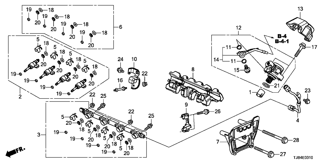

So here's the deal. They did a B1236 Service while the car was in there (it was nagging me for the past few days) and they did check the battery and said it was fine. They claim the "High Pressure Fuel Pump" caused the issue. The car is fine now, but I have no idea if this was the problem or not. The car owner now has no idea what's going on with his/her car these days. The old days of doing your plugs, setting the timing, and maybe shoving a screwdriver in the carburetor are long gone. Today? It's a crap shoot.
What do you experts think?
Here are the details:

Are these the same parts used in recall, or totally unrelated?

The HPFP was a big issue on my model of a BMW 535. It also threw a ton of codes. But they were check engine type stuff, with the engine sputtering and heating.

I think we have two pumps, recall was for regular (back seat), and the high-pressure is somewhere near the engine?

if you have a multimeter you can check the voltage of the battery yourself...
this stuff isnt hard...
check out the notes, the notes say " checked fuel rail pressure" which means they hooked up a pressure gauge to the high side and to the low side. again, something you can do yourself.
all this stuff is basic troubleshooting.
what you dont have is the HDS or the Honda Diagnostic Scan Tool. you also dont have the parts to replace for free.
the loss of power does coincide with a faulty high pressure fuel pump.
btw, BMW had went through this already and have already refined their engines..I'm assuming it's gonna take acura a few years/generations to refine this engine
if you watch the video, BMW refined their engine from a twin turbo setup to a single turbo...they've also made changes to their High pressure fuel pump. and have relocated all the heat sensitive items to a cooler spot in the engine.

found the part!
part#: 16790-6B2-A01
$477-490 new at various acura parts dealer websites.
parts diagram:
#12 is the HPFP
from the parts diagram, cant tell if it lives outside on the engine or on the inside.
Old Apr 19, 2021 | 07:30 PM
looks like it goes outside of the engine, looks to be a plug and play job
