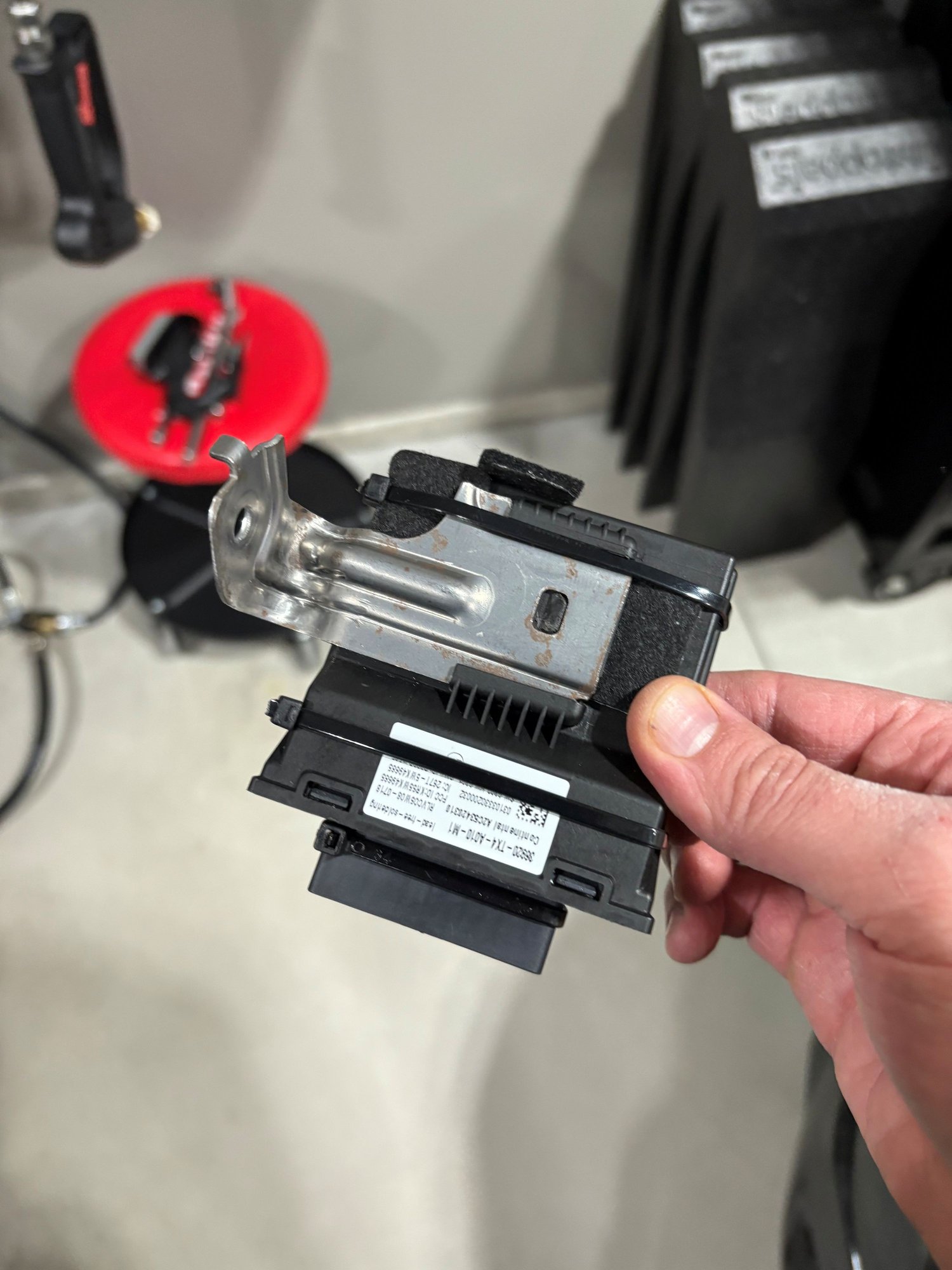

I did some digging, and the unit in your MDX appears to be the Security Smart Power Control Module.
With my 2013 RDX, I pulled the driver’s side vent and found I had a similar issue with an electrical box rattling. In my case it turned out to be the Anti-Theft Control Module.
To fix it, I removed the module and its bracket, added some furniture pads between the bracket and the module, and then zip-tied the plastic housing. The foam alone didn’t help much—the real problem was the plastic casing itself rattling where the connector plugs in. It seems like the housing is made with pretty thin plastic, and that’s what causes the noise.
The problem is that I now hear the same rattle in my passenger side dashboard lol. I'll investigate this as well.
