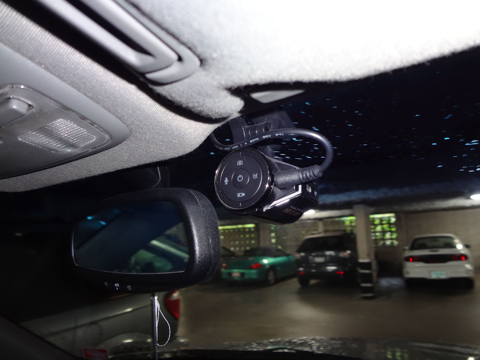

Jackel001, if you could also post a pic of your setup that would be great as well. Thanks.

Hi Guys
I will take some pictures tomorrow but I am not sure if I am allowed to post pictures just yet. I will give it a try tomorrow.

Here are pictures of my Cam setup.
