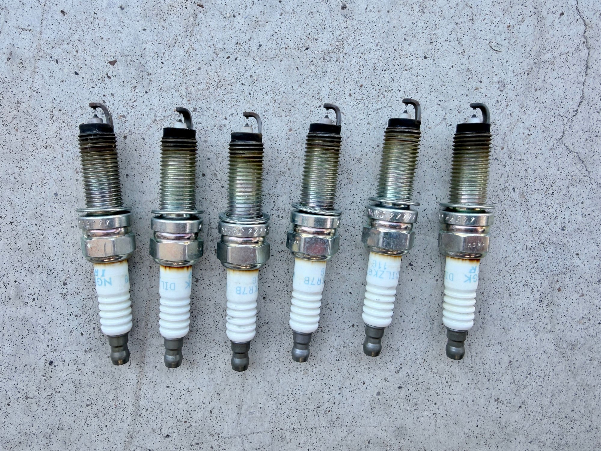

With our 2017 MDX coming up on 100,000 miles, I decided to tackle the job of changing the spark plugs. I ordered the OEM laser iridium plugs for much cheaper on Amazon from a few months ago (DILZKR7B11G 95350) although I noticed that particular set it out of stock now.

The old plugs didn't look too bad, especially after 100K miles.
