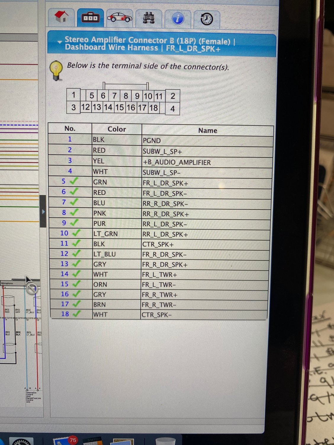

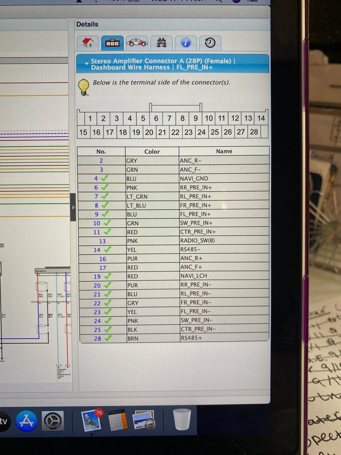

Here are the pinouts for the amplifier in your MDX.
first pic is the input connector and second pic is the output to speakers connector. Hope this helps!
Input connector at amplifier
Output from amplifier to speakers

Thanks I should have waited for you ended up paying for a 1 day subscription to express service to get the pin outs. Will help when I upgrade the stereo in the car in the next couple of weeks. Needed the full sound for the lc6i.
