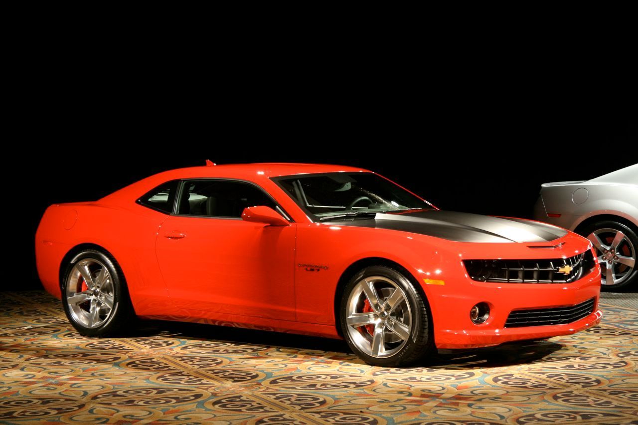

Hello all, I have been doing some research to see if this setup would work on our cars but so far I have not came across any TLs using this setup. On the other hand, there are a couple of posts over on the Acura MDX forums showing that the wheels work on their cars.
The specs of the TL SH-AWD wheels are 18"x8" with +55 offset and 5x120 bolt patterns cb = 64.1
The Camaro wheels are 20"x8" +35 offset on the fronts and 20"x9" +40 on the rears with 5x120 bolt patterns cb =67
These wheels are OEM and are selling pretty cheap ($500-$400) on Craigslist. The tire setup I thinking of using would be 245/35/20 all around with Tein coilovers for the drop.
Whats your take on it and do you think its a direct fitment without any rubs or needing to roll fenders?

Here is how they look on the car.
This is up close.
