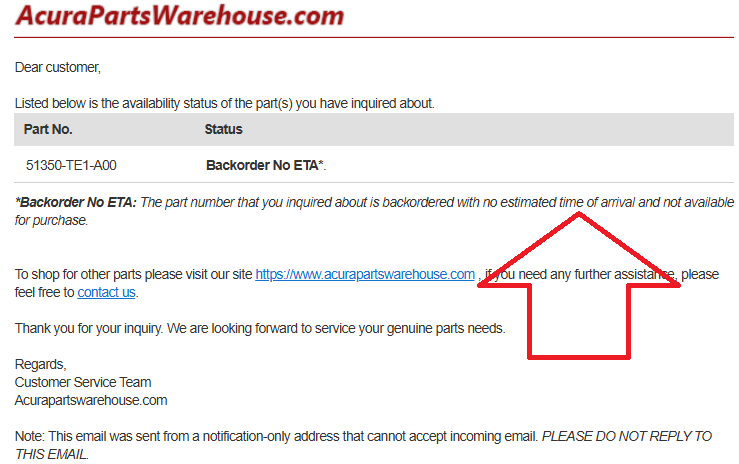

Read into it what you wish, APW.com has it labeled as 'discontinued' below & 'Unavailable'.
Then when one employs their 'Parts Availability' functionality below the response is 'Backorder NO ETA'
