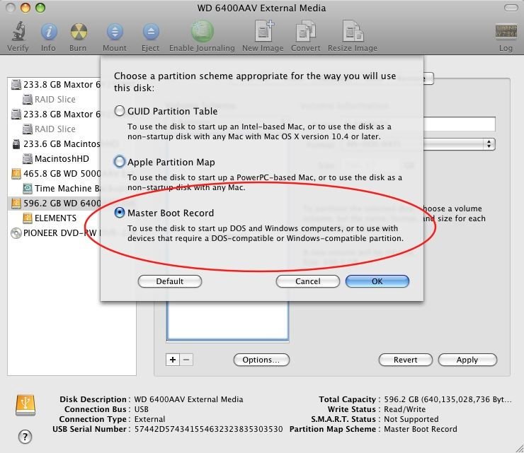

Make sure when you format the USB drive that it isn't using the GPT partition style. Macs tend to like to favor that over the Windows MBR (Master Boot Record).
That may be the difference you need to get it to play

well, if you don't mind erasing and copying your songs back onto your flash drive, i would reformat it yourself to be sure. I always format when buying a new drive. MS-DOS FAT > Options > Master Boot Record
