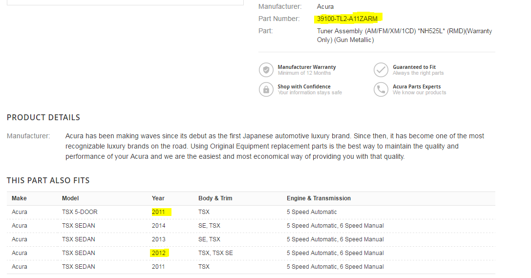

It looks like the 2012 radio will fit in a 2011. One thing to keep in mind is the security code that the radio may have. I'm not an expert on this but I know if you pull the battery you generally need to enter a code in order to use the stereo. Maybe someone else can chime in.
https://www.acuraoemparts.com/oem-pa...dXRvbWF0aWM%3D
Part Number: 39100-TL2-A11ZARM
