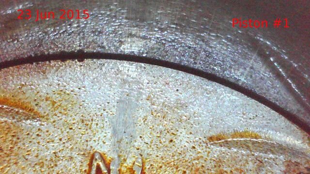

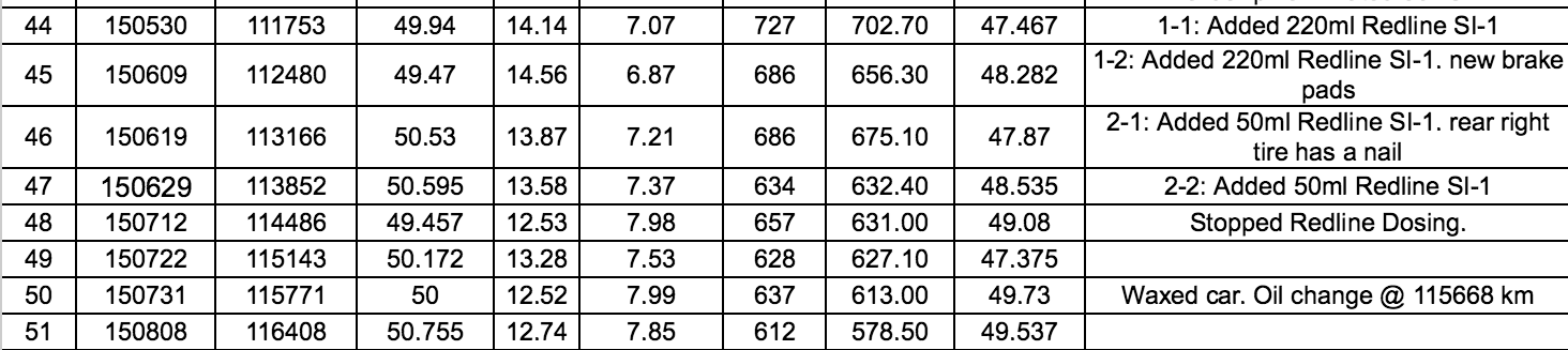

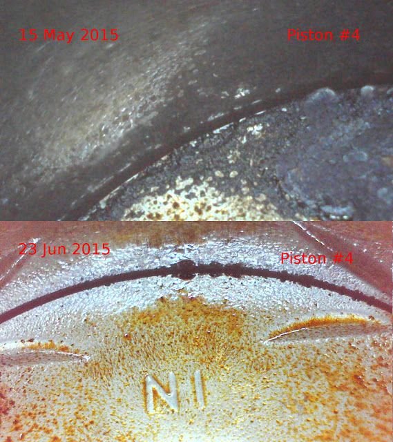

Here my piston photos after using Redline Fuel System cleaner .
There is no need to use this product less than 100k. Only older vehicles need.
But for the price per bottle, there is no harm doing it also.
My vehicle is 7 years old
1 bottle of SI-1 is 443 ml (15 Fl.oz)
First 220ml dose into tank at Odometer: 111,753 km
Second 220ml dose into tank at Odometer: 112,480 km
Full narration at Fuel Economy on a Honda R18A: INTERIM RESULTS - Redline Fuel System Cleaner SI-1

Wow it made that big of a difference? Impressive.

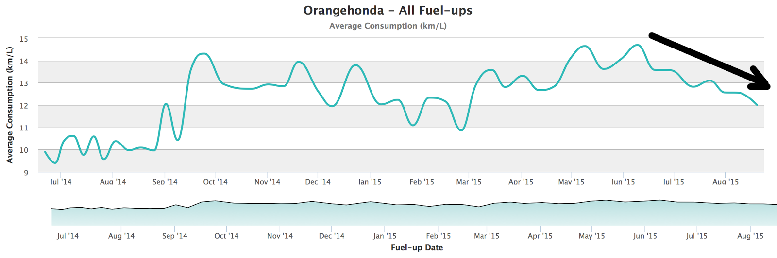

I am looking for a solution. Why is my mileage looking poor?
Since after using the Redline Fuel System cleaner, my mileage has been steadily performing poorly.
Track me at this link
Orangehonda (Honda Stream) | Fuelly

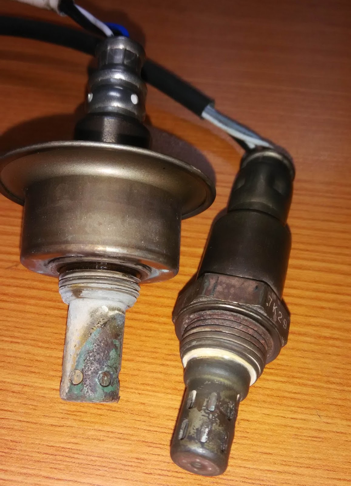

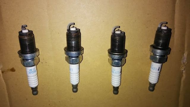

As mentioned (from my previous post), I suspect the build up deposits found at the upstream Air-Fuel sensor may have contributed to the poor mileage. Likely incorrect values were transmitted to the vehicle ECU and incorrect amount of fuel output is sent.
Side note - My tool gave way. Hence evaluation of the downstream sensor will be done after acquisition of a new socket removal arriving in a few weeks time.
The whitish residual is reportedly from the use of ADDITIVES.

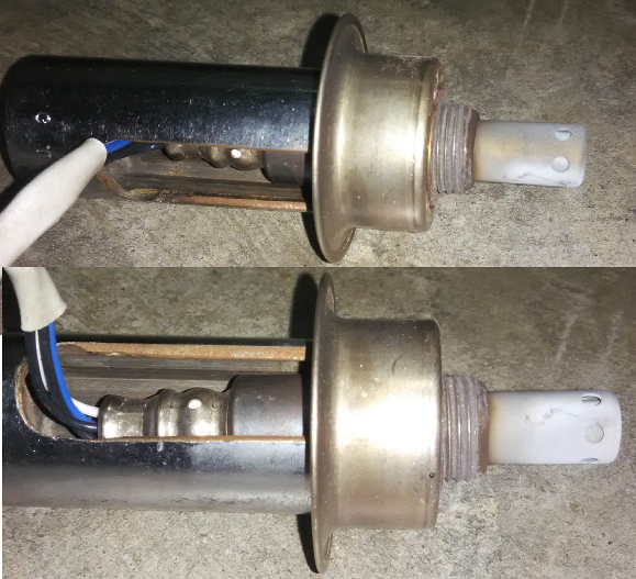

After 7 tanks later, i decided to crack open the Air-Fuel AF sensor (again) to clean.
Safety!!
Always use safety equipment to protect yourself when handling heated / corrosive / oxidising agents
I took the AF sensor and dipped into strong acid for a few seconds each time and flushed well with water. Thereafter, shop air was used to dry the probe area. The acid removed the white residuals beautifully.

Photo of used sensors - Results after application of flame in attempt to remove deposits
This was experimented on my previous sensors.
Here is the sensor after 1 day of use.
A new coat of copper slip was placed onto the thread and installed, everytime.
The sensor was working, verified using the OBD scanner after the warm up, about 10 minutes into the drive.
The trip computer reported fuel consumption steadily improved starting at 11 kpl to 12.4 kpl after 30 minutes of driving 24+ km. On the second day, the trip computer reported an increase to 12.9 kpl
Cleaning one sensor at a time will reveal the impact of individual sensor and their effect to fuel economy.
Expectation from cleaning AF sensor: If the fuel consumption does improve, then i can confidently say that the additive or dislodged deposits did clog up the sensor probe.
No doubt, the Redline Fuel System Cleaner does its job well at cleaning. However the sensor probe residual must be removed to restore the performance after usage of additives, even when label says it is sensor safe.

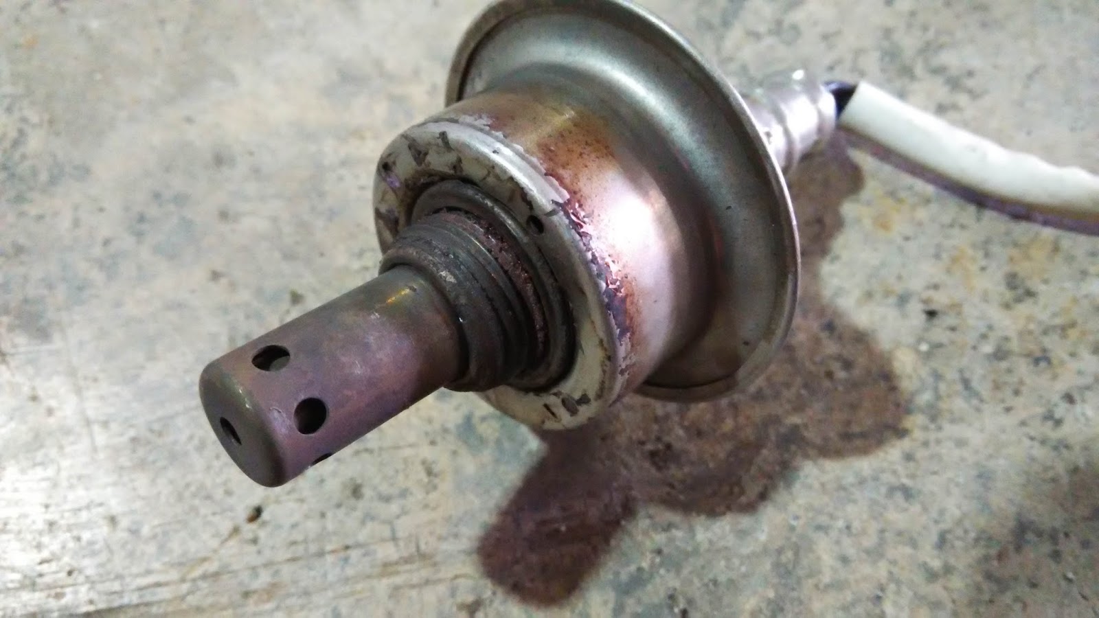

Results from cleaning Air-Fuel sensor
Fuel Economy on a Honda R18A: Results after Air Fuel sensor cleaning
In the last post, the Air-Fuel sensor had white deposits on its probe.
I had them cleaned. The mileage has improved tremendously.
You can find the previous article here:
Fuel Economy on a Honda R18A: Reversing a downward trend, after using Redline Fuel System Cleaner
The reported mileage from the trip computer crept upwards, first from 11 kpl till 13.7 kpl (today).
I still have a bar left of fuel. Surpassing 632.4 km (Jun 29 record) for this tank should be fairly doable.
Hence, clearing the air-fuel sensor did yield positive results
It also meant that additive deposits can be removed from the sensors with success.
