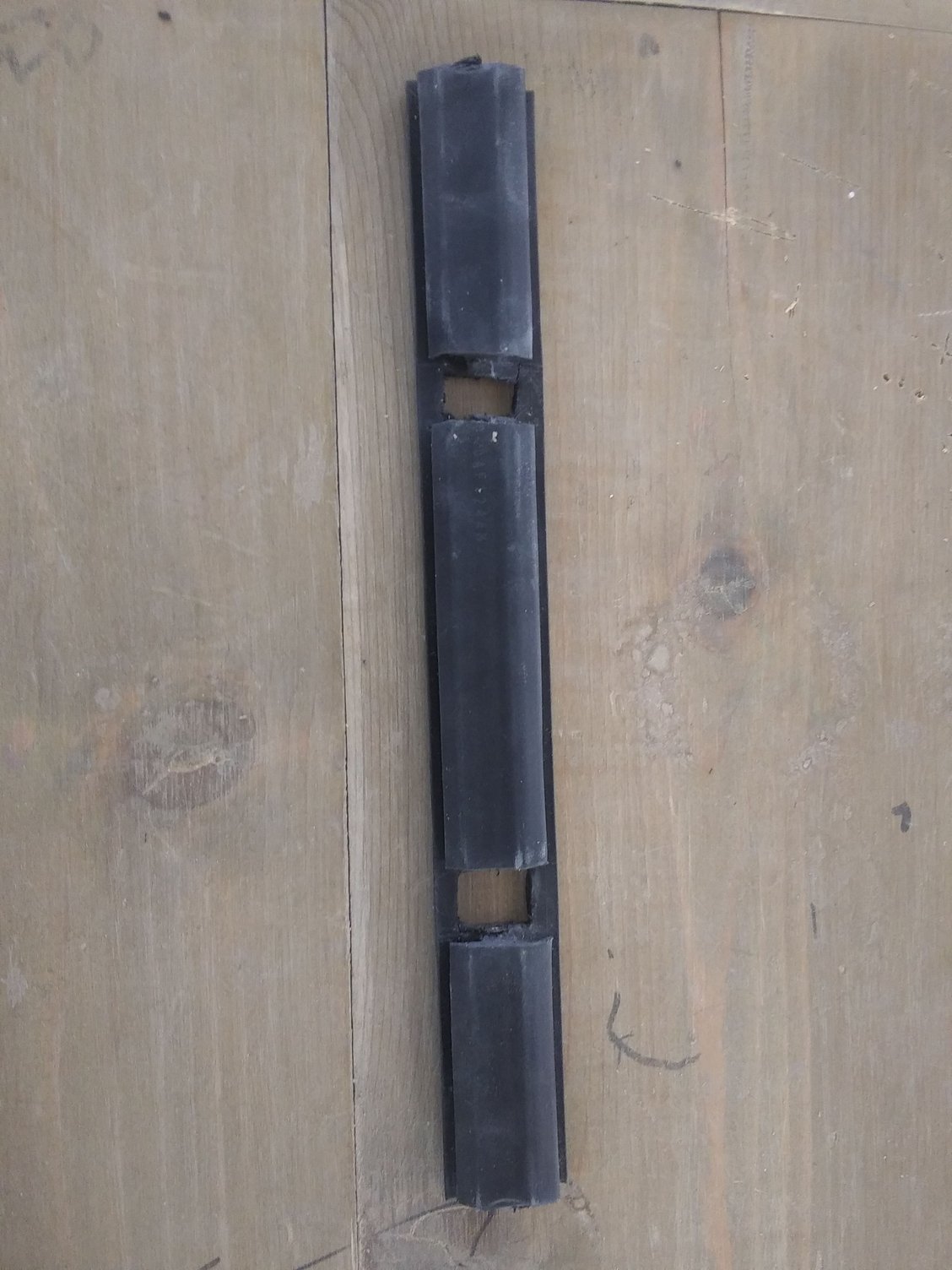

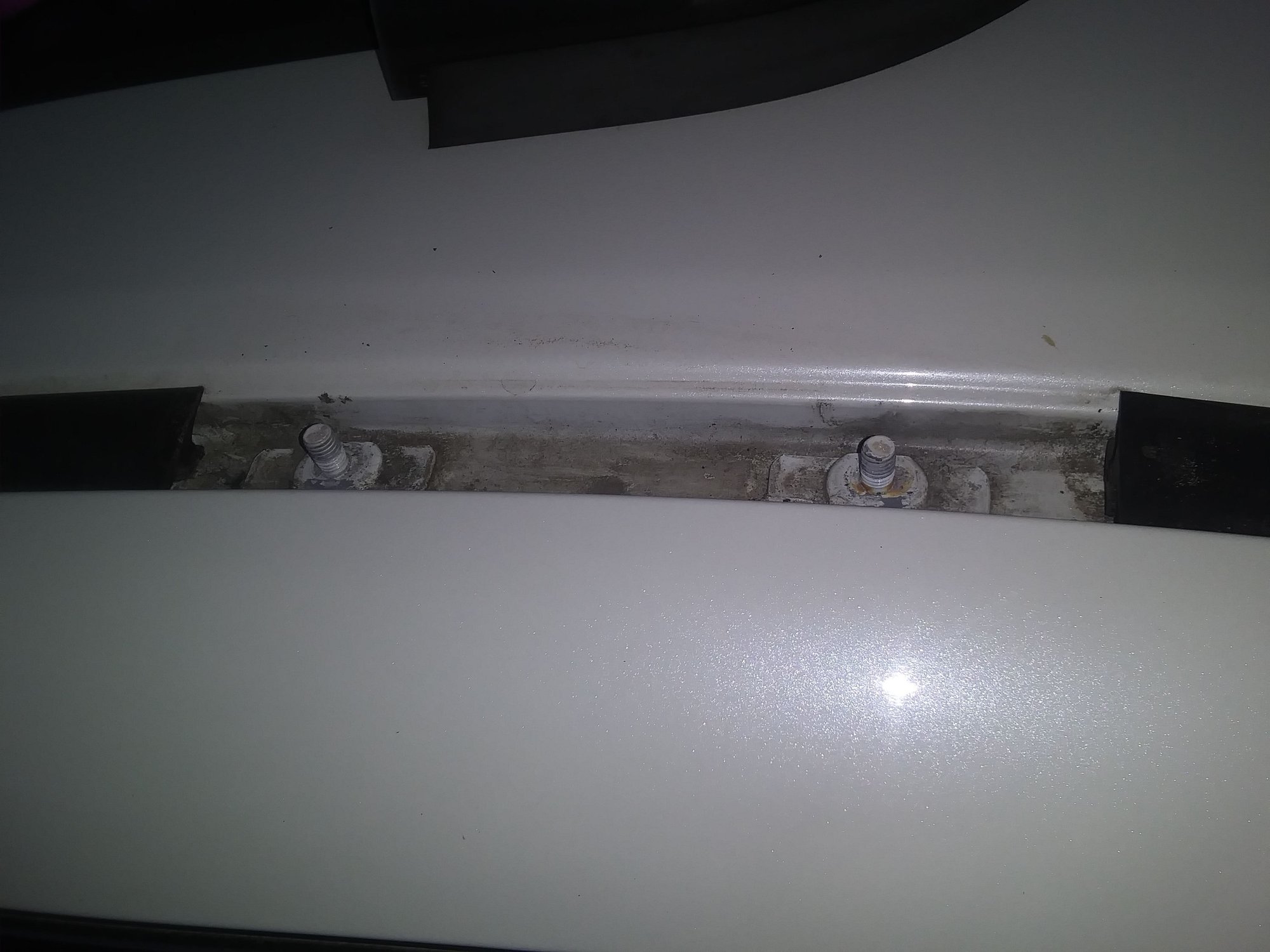

After removing the rails you will be left with something looking like this, thats where the oem roof molding comes in. You're going to cut it up to fill in the gaps in the channel to put the 1 3/16 molding on. Measure twice cut once. I still messed that up but its not a big deal. However i did discover that the long roof molding isn't long enough to get all the pieces you need but you can still make it work. I chose to leave the middle rail section alone as it has the smallest gap. If you wanted, you could order a smaller roof molding piece to fill it in for piece of mind but it's not necessary. I provided part numbers for both pieces L and S.
You will have 3 partitions that look like this when you remove the rails.
Now that you have your pieces cut to desired length it's time to cut them up to fit over/around those pesky mounting point studs. This is the most time consuming/pita part but in all reality it's not hard. What i did was press the pieces onto the mounting studs to get an idea of where you need to cut. Place the molding into the channel as if no studs were there, press down firmly, it leaves an impression that you can go over with a marker so you dont lose them. On one side i tried drilling but I came across 2 problems.
1. Rubber is annoying to drill and 2. the molding has a metal strip running through it for strength/rigidity. Solution? Dykes and a really sharp blade!
after you make your marks use your blade to cut the rubber down to the metal like in the picture. Once you reach the metal strip use the dykes to cut the metal strip out. After you finish that up lay the piece flat and cut out squares in the rubber so the studs can poke through. The studs will come up almost flush to the rubber but barley. If you dont do this the trim will bulge and if you lay the molding o. Top it will bulge and leave a gap.
This or something like this should be your finished product.
