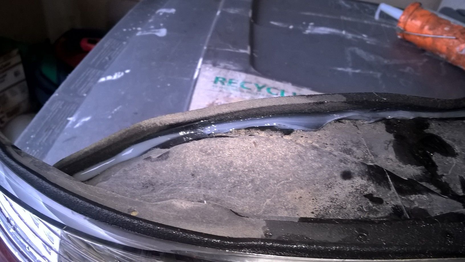

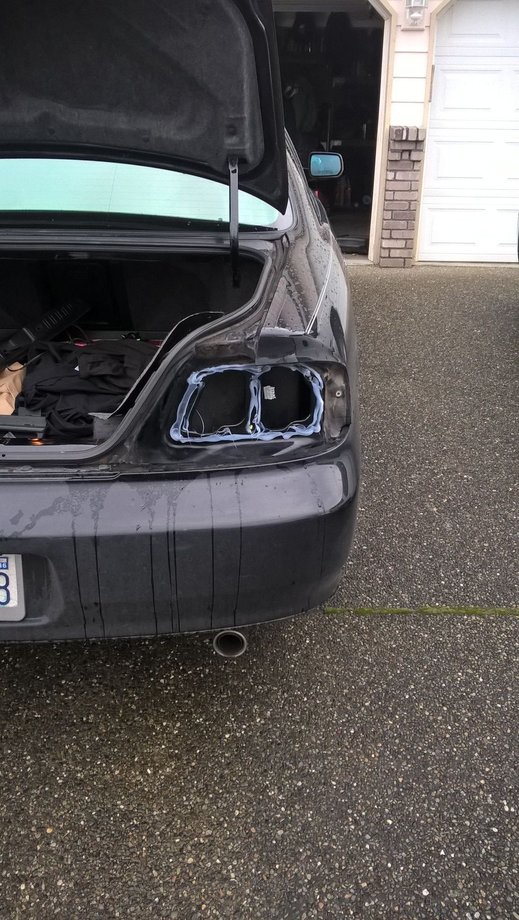

I read the other posts and knew there had been water in my trunk, but I pulled the plug at the bottom as a temporary measure.
I thought I would post pictures of my repair, it really is easy and does not cost much time in materials and time.
I used Bath and tub silicone from GE from Home Depot.
https://plus.google.com/u/0/10973774...42220488032572
I used the silicone in a logical pattern. The extra course on the back side of seal was redundant since I cleaned the car side and caulked around.
I hand tightened the nuts on the inside of the car and will mechanically tighten tomorrow.
Hope this helps. easy job and its clearly a problem for these crappy gaskets.

I think both of mine were leaking. dry as a bone now.
