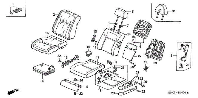

also, trying to find more clips so that i can re-upholster the seat after fixing the heater. here is the diagram:
are the clips used in (28) any different from the set offered in (1)?
hoping these pliers i have can do the job. worried that removing them will be a chore, but it seems less so after looking at this link: http://joshsworld.com/cars/acura-tl-seat-heater-fix/

The clips in (1) are upholstery "hog ring" clips, like this: https://www.amazon.com/Drake-Off-Road-PLIERSET-P-Professional/dp/B00FS0WFAA/ref=sr_1_1?ie=UTF8&qid=1484939656&sr=8-1&keywords=upholstery+clips. (28) are plastic clips that slide into a slot on the seat back, and snap into the seat (and will break when you remove the seat back). Like I said it's possible to remove/replace the hog ring clips with needle nose pliers, and if need be you can use zip ties when reassembling (I did zip ties on one seat, and re-used the clips in the other seat. Both worked fine).
