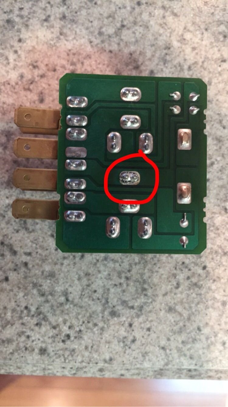

ck the relay board back side for solder issues, ck DIY or threads on the subject for pics and help

Update:replaced the fuel pump relay. The old one definitely looked a little brown in some spots and one of the solder joints definitely looked suspicious/corroded. Hopefully it worked

Seems to have done the trick. Heres the old relay

did you remove the board and examine the part the relay connects too?
bad solder one place = ....
