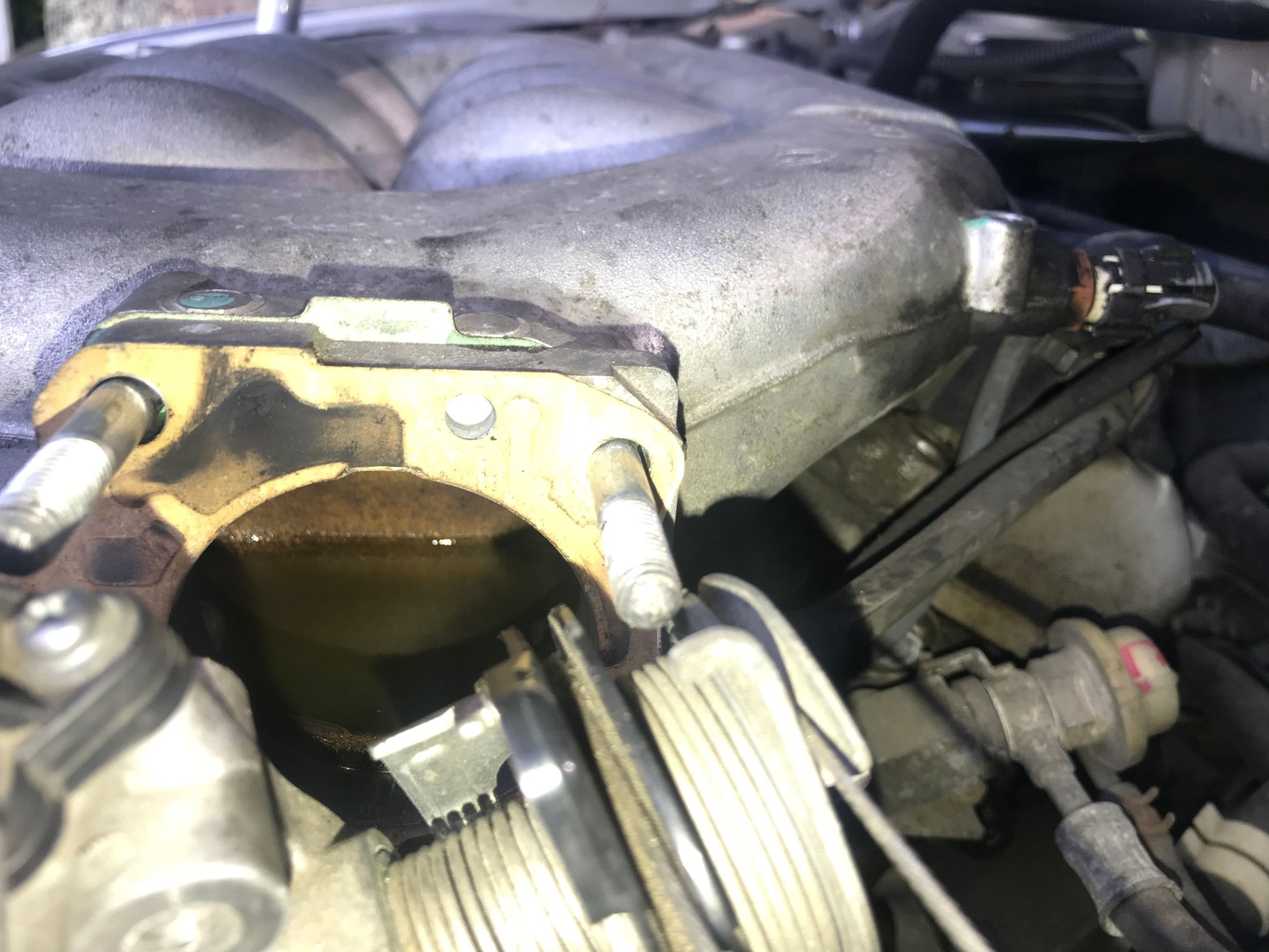

I have a 99 Acura TL I’m working on and the intake manifold keeps holding coolant. When I first noticed it there was a puddle in the air filter hose and in the front of the manifold where the throttle body sits. Can anyone help point me in the right direction or something?

FWIW; You may want to take a look at: Youtube: ( P0401, 1999 Acura TL Honda V6 - Eric The Car Guy ) In this EGR related issue, Eric explains, one reason, for water accumulating in the intake manifold.
