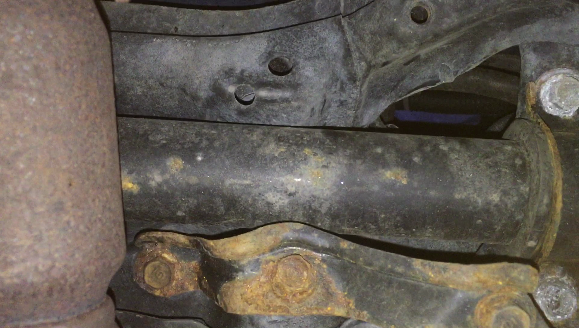

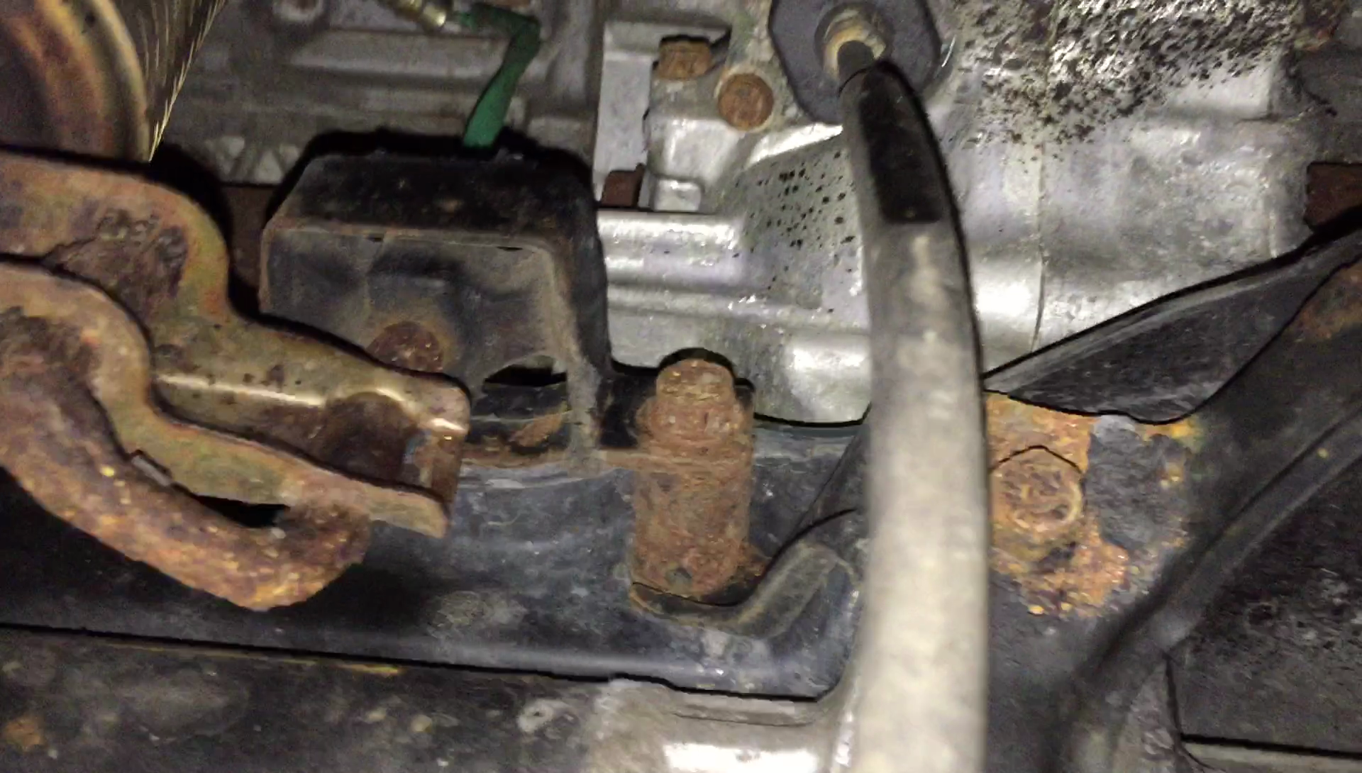

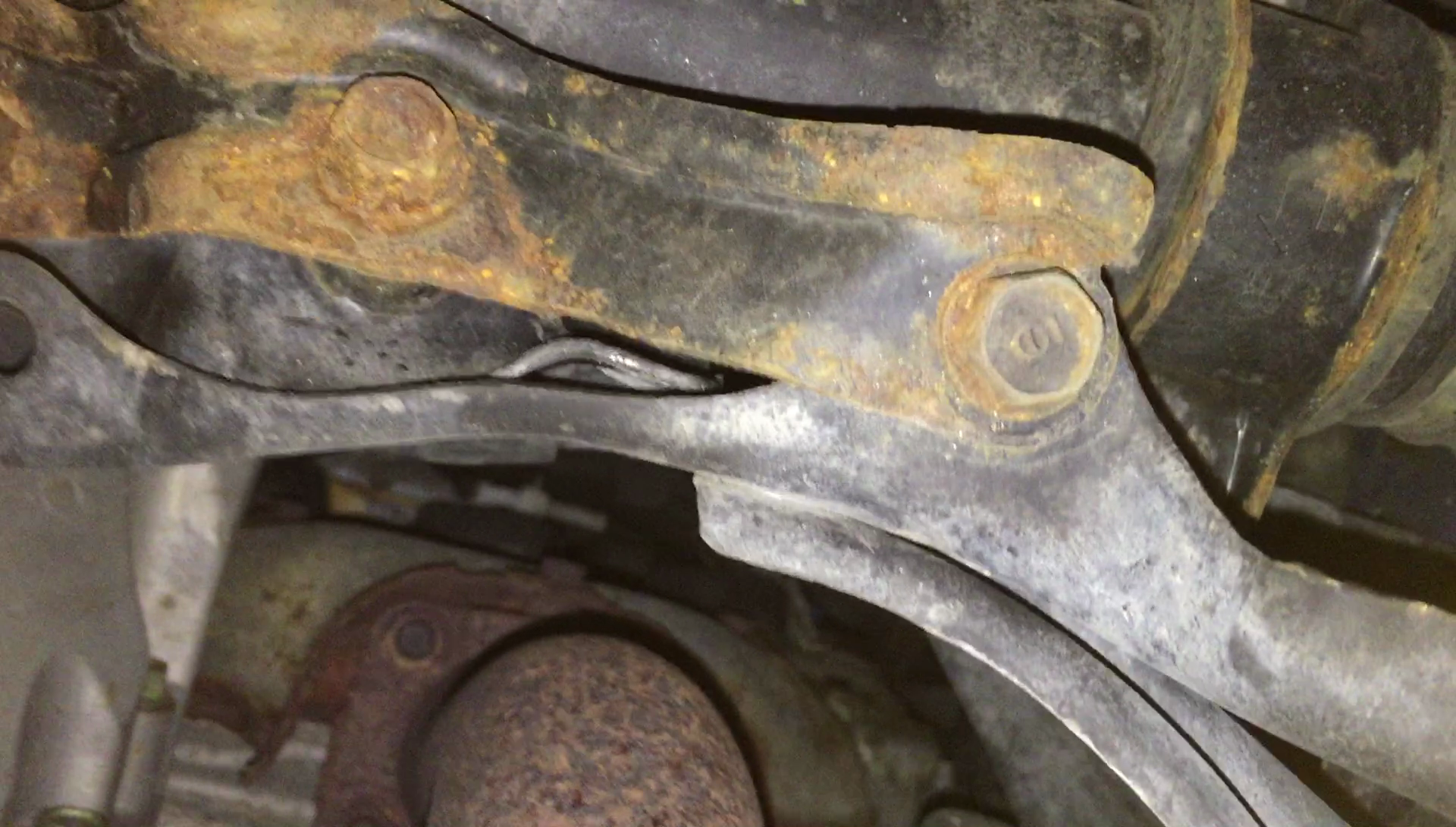

stiffer steering rack
steering rack bushing
stiffer rear beam
stiffer rear beam
Old Apr 24, 2017 | 11:17 PM
blackhorse21's Avatar
Joined: Feb 2016
Posts: 39
From: Cleveland
I took photos from bottom. The stiffer of steering rack has one end looks very rusted, but the bolts on the other end is barely rusted. Which makes me wondering if the paint was busted by the hitting and then cause the rusting to happen. Or it is simply because the position is lower? The stiffer for rear beam is also rusted. The steering rack bushing looks not bad. I tired to pull or push and not seeing any play. I actually send the car to a shop and they said it is inside the steering rack where noises comes. The replacement will cost $1254 including a 4 wheel alignment. I am not sure about the result since I don't feel any wire play on the steering wheel. But only to hear some clunk noise during low-speed and fast turning. So is it still possible the stiffer that is damaged? Please let me know your suggestions~

Hard to really tell but the bushings and mounting paints seem ok. While cruising can you move the wheel side to side a bit without the car really reacting? A loose feel to the steering would lead to inner/outer tie rods and or the steering rack altogether. I still say to mount a go pro or something under there and re create the issue a few times.
That $1200 quote is RIDICULOUS! A new rack is like $300, if you can install it yourself, do so. If not, go to another shop, the install and alignment should be half that. If their really good, they can measure/match the current settings while installing and wont need an alignment.

Thank your for reply. I tried on cruising and didn't notice any significant play(no reacting steering) on the steering wheel, maybe a little for a few degrees. Will see if I can find any shop to do the job for me. Can't do the job in appartment's parking lot.
