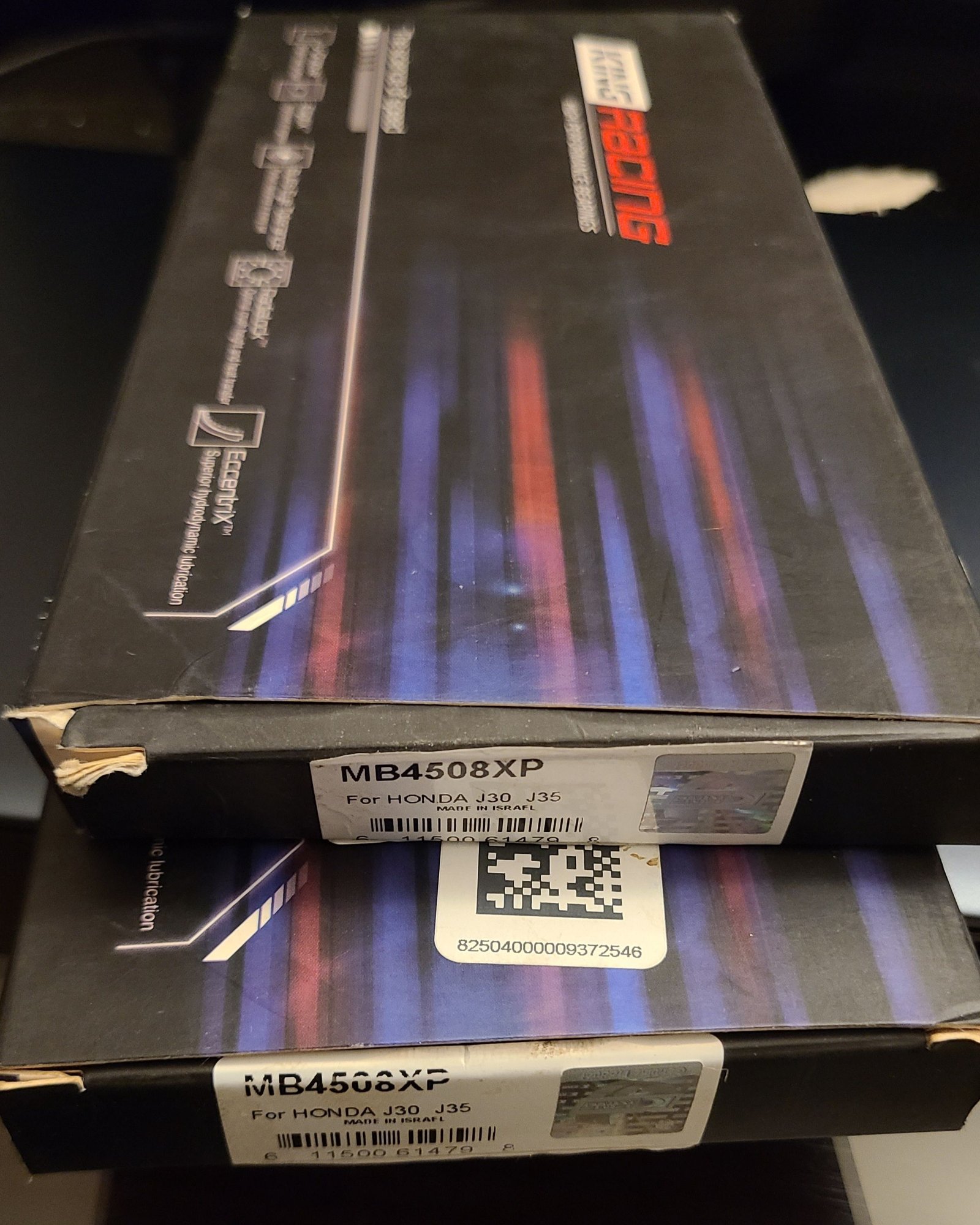

King is good. I use their XP line of bearings (i.e. MB4508XP)
However, unlike factory bearings which come in different thicknesses, aftermarket bearings are produced as one size. So, you may end up with uneven clearances from one journal to the next. Which I am starting to suspect as the culprit in your situation. A wobble in the crank, compounded by high load, high rpm.
