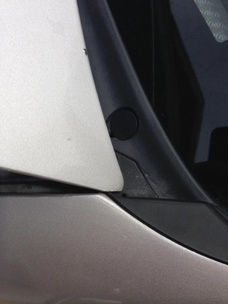

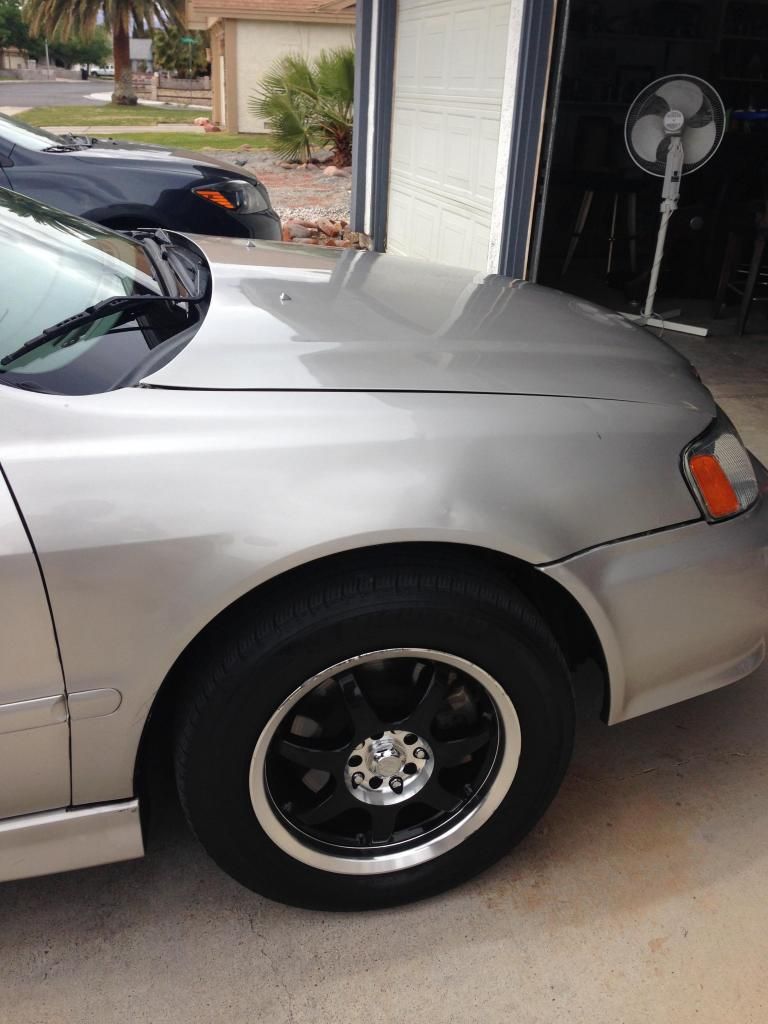

Hello Acurazine, I tried to use the search for this problem but didnt find much pertaining to the problem im having maybe thats because its pretty basic im not sure however I've never had to adjust a hood before and I would like to know how and that I am doing this correctly I bought this 99 TL recently and got it for a good price as the guy who had it before had been in a front end accident and im assuming he attempted to fix the front end himself cause it fits really sloppy unfortunately for me im a perfectionist and this has been bothering me since I bought the car so im hoping ill be able to adjust this thing and get it fitting right anyways If you look under the grill you'll see that one side the gap is bigger than the other and up at the top of the hood you'll also see the hood pops up im not a fan of that either... after looking at it a little bit more i realized he just had the hood on crooked I belive if you look at it.
Can anyone help show me how I Adjust this? the guy tried to fix it but all he did was jack it up and im tired of looking at it this way. thank you to anyone who can help and sorry about the image size I couldn't resize them.
TOPLEFT HOOD:
[IMG][/IMG]
[IMG][/IMG]

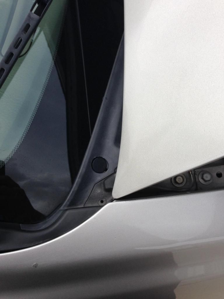

TOPRIGHT:
[IMG][/IMG]

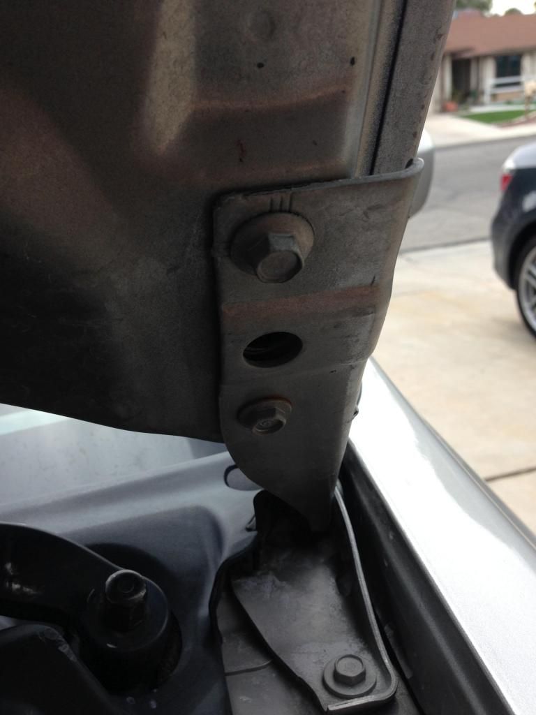

What what I "think" and granted I'm no expert but if you look at the top left... Then look at the top right of the hood... And I'll try to post some pics but if I were to pop the hood up and underneath the hood where it attaches at on the passenger side it is a good half a inch lower then where it is attached on the driver side. I'm unsure about if the parts are new or not but the only bent part I see is the hood latch which is what I thought at first was causing this problem however I don't see how that would have any effect on why this hood is on completely crooked and why it is so far down below the headlight on the passenger side but not on the driver side

Yeah, depending upon the impact and what all was previously damaged.....the mounting points may have been altered due to the force of the accident. Post a pic of the front fender alignment along with the hood's latch and rear hinges. Might help visualize the body panel's alignment better.
Sometimes ya can cheat a bit by egging the mounting holes or using shims to even out the difference. Try loosening up the hood's mounting bolts and attempt to realign the positioning of the hood. It could be that the rad support or latch is twisted back ?

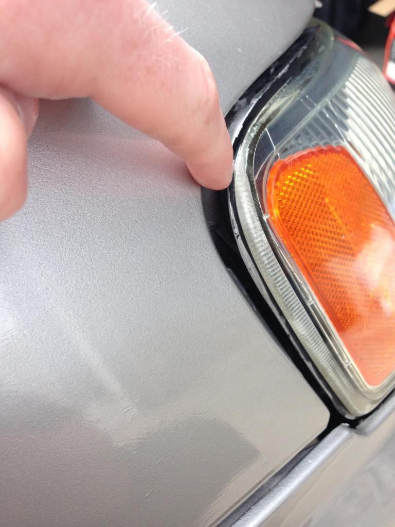

Fender:
[IMG][/IMG]
Fendergap:[IMG][/IMG]
Fenderheadlightgap:[IMG][/IMG]

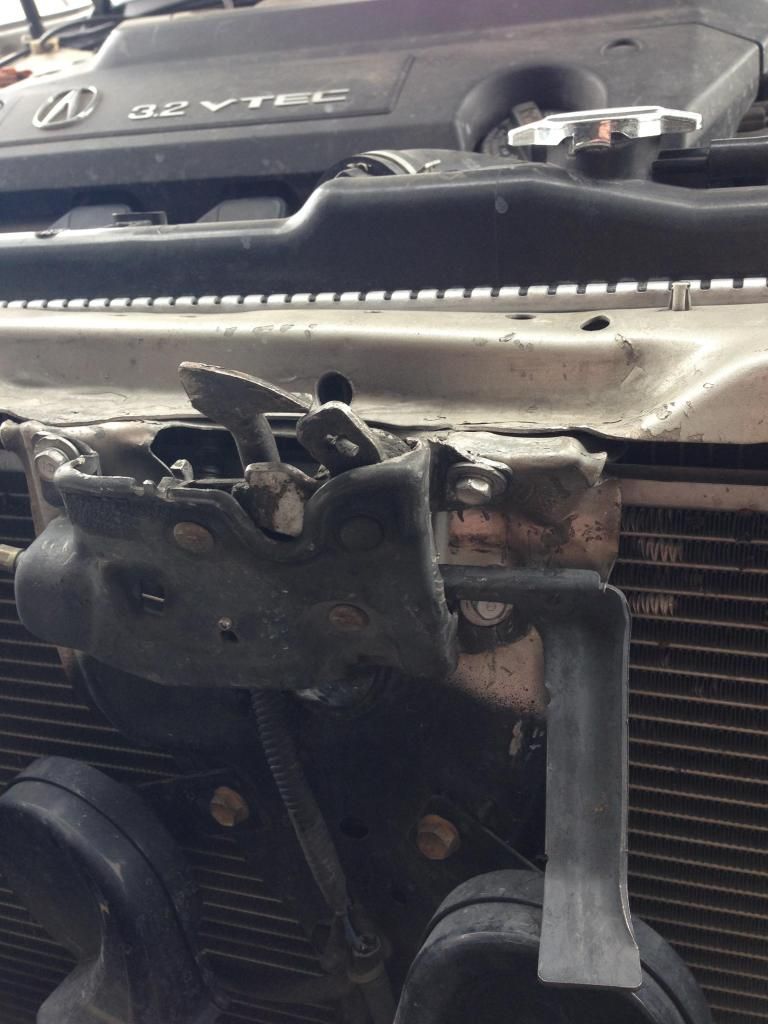

Hoodlatch:
and now the reason I think the hood has this gap this is where the hood is bolted on both the driver side and passenger side while my hood is popped
TOPLEFT:[IMG][/IMG]
TOPRIGHT:[IMG][/IMG]

I think you should get an estimate from a body shop. You have multiple issues. From what I can tell, both front fenders need adjustment before you even think about the hood.

First off, I can see that the radiator core support is bent. That's why when you close the hood, you can see a nice gap where the hood meets the headlights, and on the other side, the hood is over-lapping the headlight seal.
That jacked-up hood latch doesn't help either.
Depending on the severity of the frontal impact, the strut towers might have shifted a little. Since so much rides on the radiator core support being straight, and the strut towers being in the right place for the fenders, if they are bent, even 1/4" of an inch, it can throw off the alignment of the hood.
You can shim it, cut it, slot it, weld it, slice and dice it, it will not make any difference. Bent is bent. Take it to a body shop, get an estimate. Then you'll know how much you'd have to put into it to get it straight.
