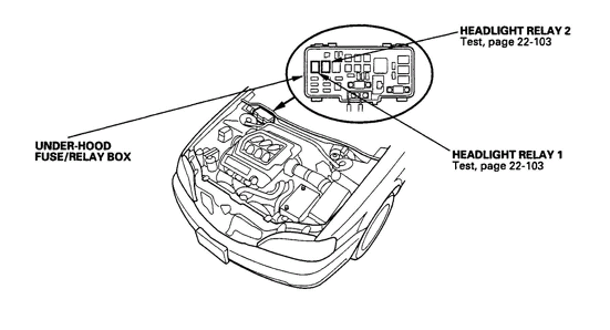

I think you have a bad relay. Swap places with your headlight relays. If the problem transfers to the right side, then replace the right headlight relay.

Yeah it wasn't the relays at all... Do you know if it's fixable or I for sure have to get the piece?
