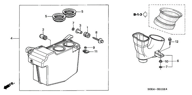

also, just to rebut any potential "dude it's just the resonator it doesn't do anything but silence the sound", i point you to the following diagram which clearly considers the resonator as a part of the vacuum system:

^ Not sure why you're rezzing an old thread, but you're post has a lot of misinformation. The resonator IS just a silencer. Removing it does NOT affect the car's vacuum system, nor does it change the metered air intake. Any kind of problem of "self revving" is entirely caused by a vacuum leak. This is usually the IACV in our cars.
Also, your IAT theory is wrong. It won't cause that level of surge. As maybe the only one on this forum that has actually tuned a 2G, I can show you all of the maps that use IAT. It is certainly used for idle target values, but it won't be enough to cause that kind of surge. You need a straight up vacuum leak for that.
